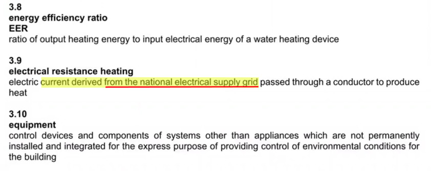

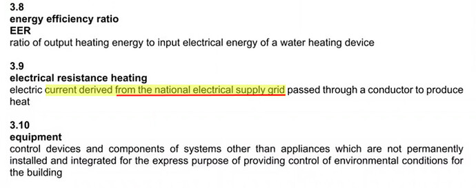

Also intersting for me is how XA2 has become a blanket “no electric element allowed” mantra. The SANS 10400 definition of “electrical resistance heating” actually appears to say something different:
As it reads now, the problem is not the method but the source of supplying the method. If 50% of the heating is done with “none-grid derived electricity” XA2 should still be complied with so, if having ample surplus PV that feeds a traditional electric geyser this should also satisfy XA2.
