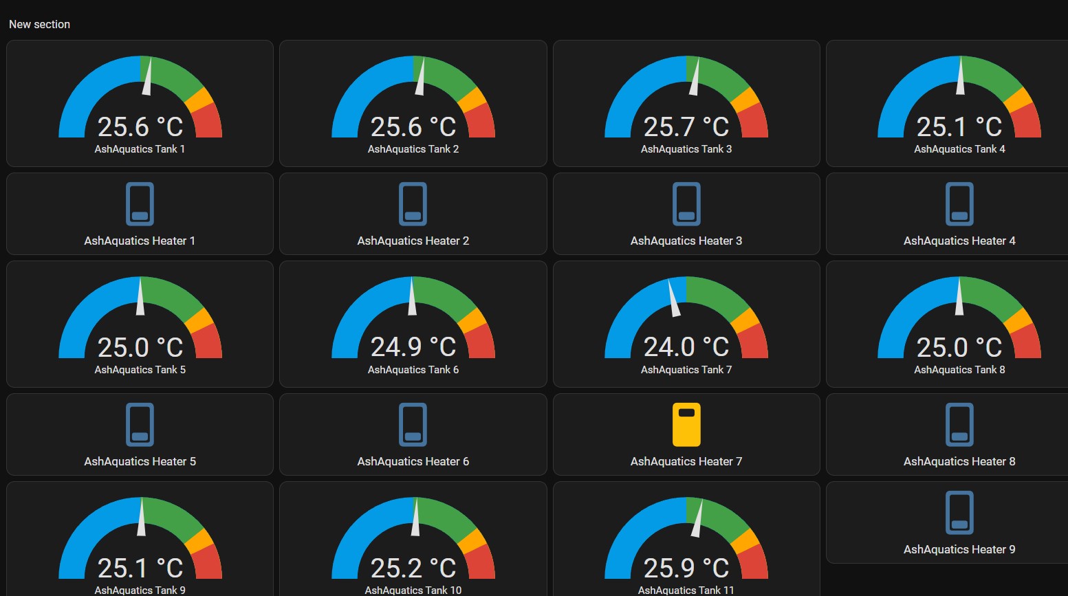

Last night @22H30 I was done installing the aircon and switched it on as a test. I set the aircon at 26degreeC and dropped my temperature control on all my existing heaters to 25degC as a backup should my aircon plan not work. To explain this a little bit better. I took my plan to 2 different Refrigeration company’s and asked them what I should use to do central heating in the new fish room and they recommended a minimum of 36000 BTU. I did not agree as the size of the room requires a 18000BTU.
I am currently waiting for the manufacturing of High density insulation panels for the roof area as well as all the glass areas on my sliding doors. In theory insulating a room would result in a smaller aircon requirement. I had a 12000btu available for use and decided to test it before I spend any more money and with the recommendation of the experts in the back of my mind i started doubting myself. Went to bed at 23H30 and woke up just after 4 this morning to find this. Please keep in mind the insulation is not even in place yet. I was pleasantly surprised. I removed the temperature probe from Tank 11 to hang in the air and indicate the room temperature for this test. Now to see how this system will react to the addition of the insulation as well as the 80 or so outstanding tanks. (Something wrong with the Tank 7 tank as it is indicating a lower temp and not fluctuating at all)

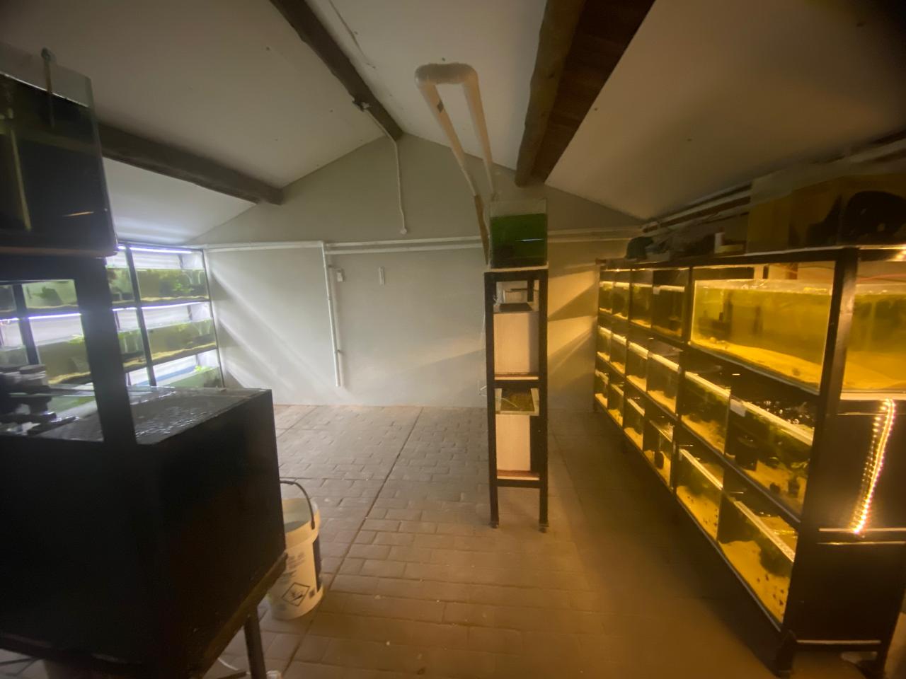

Coming along slowly. Insulation only partly done and already a huge difference.
So the first 84 tanks is in place with space for another 3 for now. Ill stop here first and see what happens before we expand.
That looks like a very nicely thought out setup :+1:
