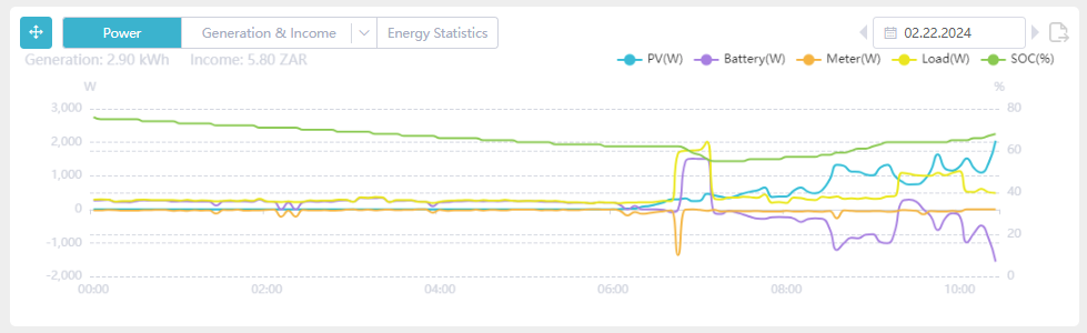

So this morning with
  • Firmware = 2525J
  • Inverter in economical mode
  • Load shedding
  • Not great PV but still some
We see
You can see the load drop at 10:00 when the load shedding starts.

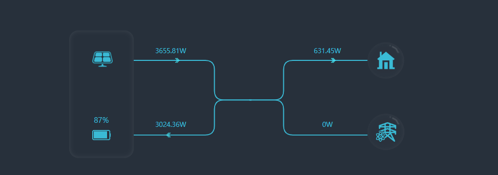

So with this version of the firmware, in economical mode. the Goodwe is charging the battery when there is PV but not grid.

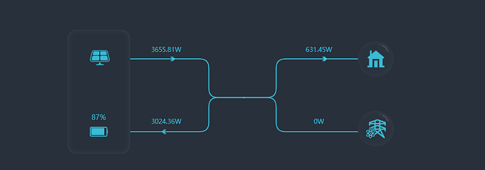

And just to drive it home
That’s with loadshedding still ongoing
That looks perfect…problem solved?
