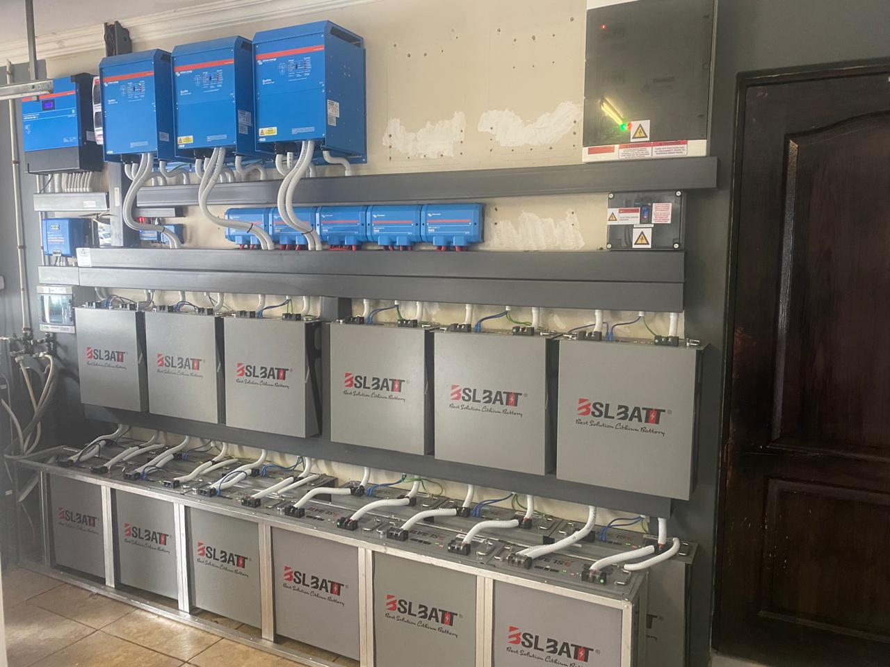

So the last 5 weeks we have been on the road in Natal waiting for the builders to finish in Capetown so that we can move over to the cape. Got delayed for 2 weeks already with the heavy rains up here. Could not complete roof work or open tiles. rain was really bad.
First we inherited a site that no one could stabilize. The original installer disappeared and two other companies’ were called to sort it out, but failed. We made a few changes and added 6 batteries and a few other components. System rock solid for the last 5 weeks.

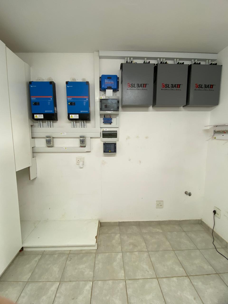

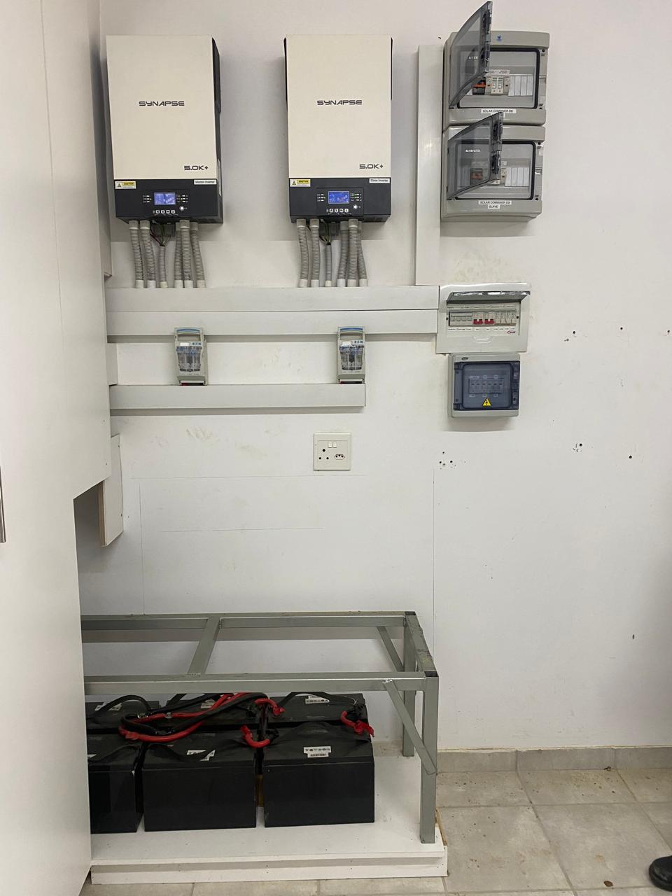

Then we helped a client that paid R160k for the following install. We replaced with Blue and a more reliable battery bank. Spaces at the bottom is for fridges and shelves with tool boxes.
After:

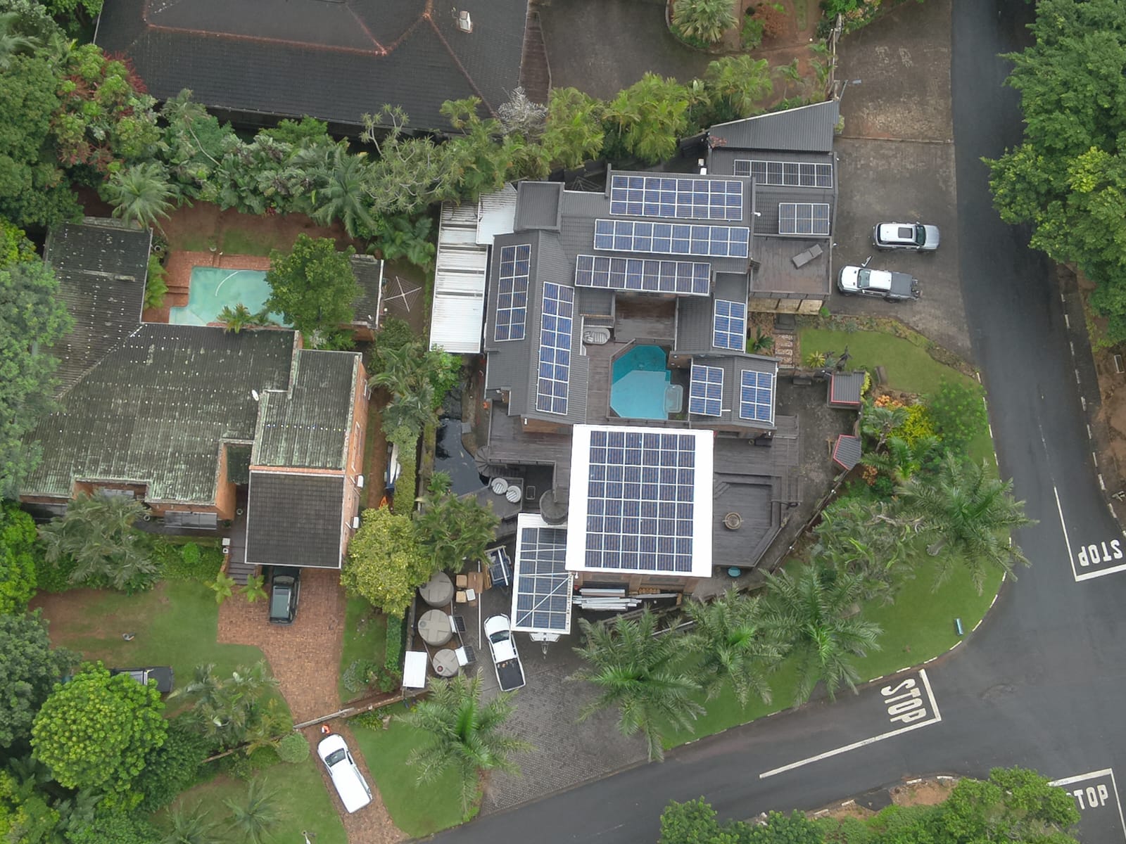

The third job was to install a nice big system for a client in Balito. 54 x 595w Bifacial panels on the roof and Phase one on the inside wall. Still 10 batteries outstanding on planned phase 2.

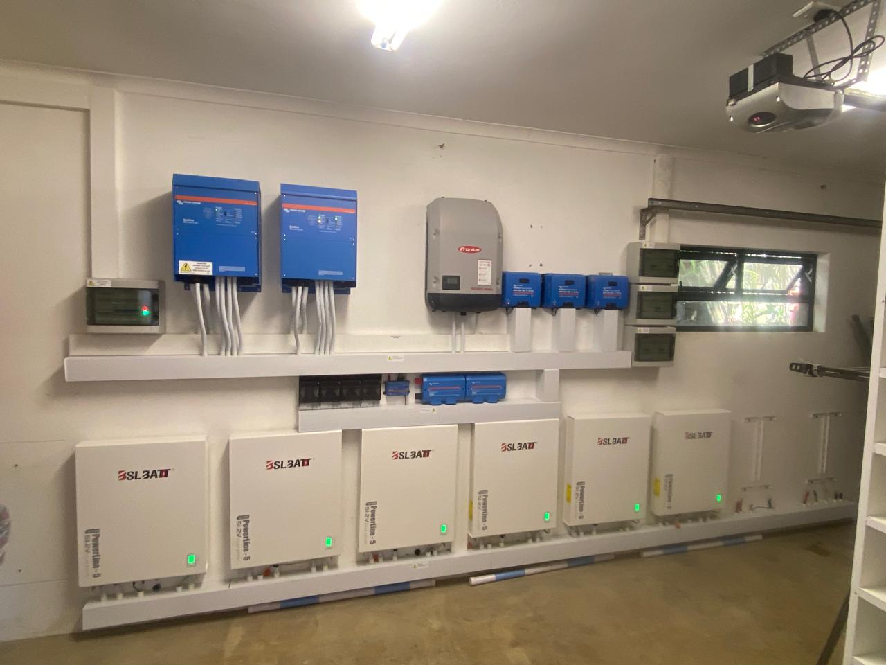

Number 4 for this trip, Rip out the bar install way up in this post. Combined the panels from both installs and adding a fronius and 17 more panels to the system. Also added another 15kva quattro and still have to add another 7 x 15kwh batteries. Changed the angle of some of the panels as well as restrung a few strings to maximize MPPT’s and Fronius.

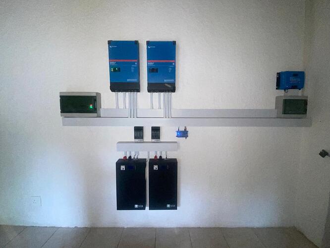

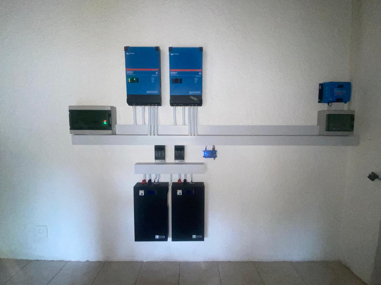

Me and one of my guys arrived back in Gauteng just after 11 Thursday night and my team at 11 Friday night. Quickly attended to a few important support issues on Friday and yesterday morning I collected spares for our new install in Noordheuwel Krugersdorp. We completed the Noordheuwel Install at 3 today…
2 x 5kva Multiplus 11, 2 x 5kwh Batteries and 12 x 550 Watt panels on the Roof.
As usual, space was left for adding more batteries, another Mppt and Inverter should the clients needs change in the future.
I am going to do something that I normally would not do. I am going to talk about price. THis client got a quote from a big name in our Victron approved installers circle. He was quoted R237k for 12 panels on the roof, 1 x 5kva and a 5kwh battery. We did this job for just under R160k. Double the battery capacity and double the inverter power.

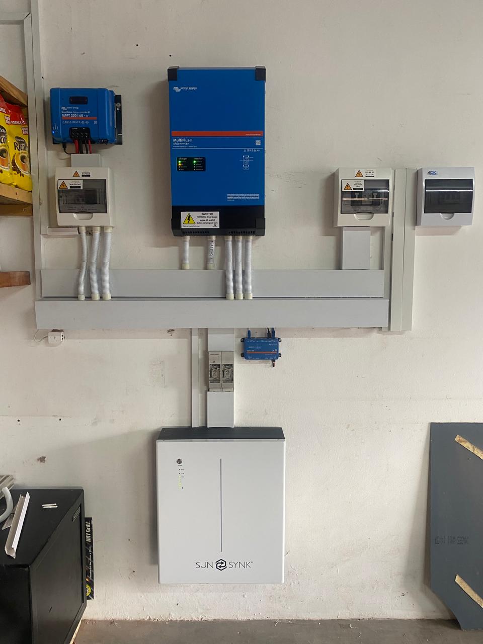

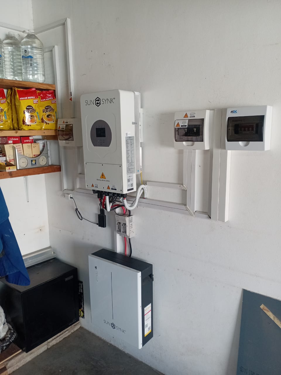

First before I post today’s job I would like to clear up something first. I am not knocking the brand. They have a space in the market and they are definitely not the worst alternatives around. My joy in replacing one of these comes from the punches thrown at end-users over the last two years. Approved installer losing their approved status leaving their installs without warranty. Politics and changes in the supply chain and repair centers, and the extended 10 year warranty that is not honored anymore due to simple politics. We replaced a Sunsynk with our prefered brand and used as much of the layout and existing switchgear as possible to ensure we save the client on labour and consumables.
I need permission to post the before picture but here is the after.
Before:
After:

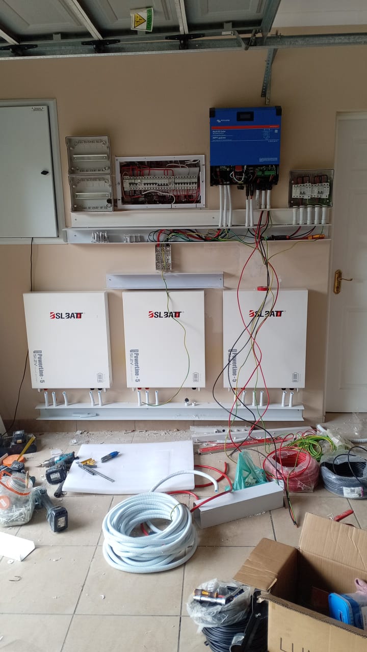

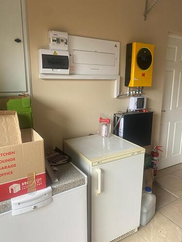

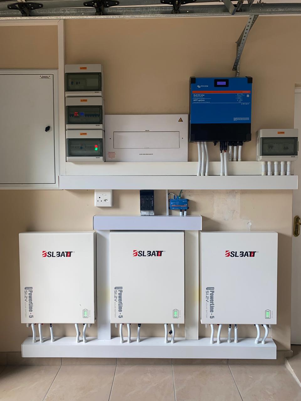

And today we started another replacement.
Replacing with a Multi RS, 3 x 5kwh BSL Power Lines and 8 x 550 watt panels on the roof.
Should be completed tomorrow.
And Done.
Interesting one. Some loads on Grid, Some on “AC-Out2” only switching off when SOC is below 50 and the rest on AC-Out1.
