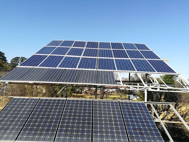

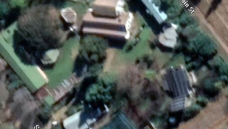

It isn’t actually that big of a building. It’s just that with a reasonably shallow pitch and the roof ridge pointing North, the entire roof is suitable for panels.
It is actually my Mother’s granny flat. My sister runs a guesthouse from the main buildings:
My mother is off-grid, and my sister uses all the excess power.

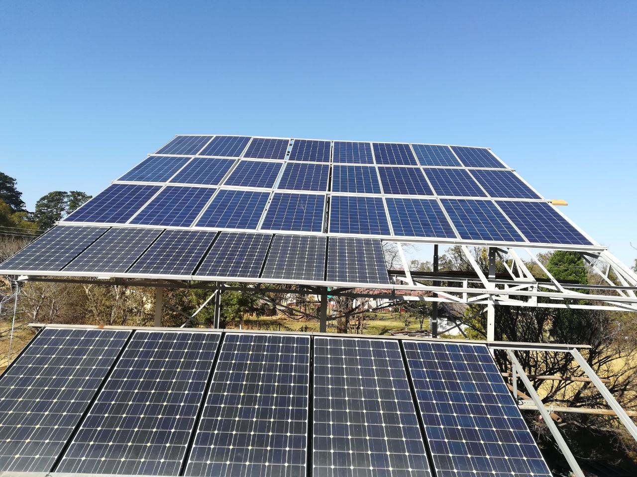

I just found an under-construction photo of the tower I built. (It was taken standing on the roof a few years ago now).
That 8x8m platform certainly contributed to the panel real estate.
I forgot the last row of panels on the South of the roof straddling the ridge is also angled North.
All the other panels are E & W, following the pitch of the roof. Initially, the whole roof had frames like that, so I built the tower to get rid of those frames. It looks much better now.

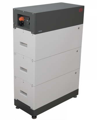

The battery is modular.
Selection_426
So you have a base, several modules (which means you can decide how much capacity you want), and then you have the BMS/BMU on top, plus a cable set that plugs into those nice connectors.
That’s why they are individual items.

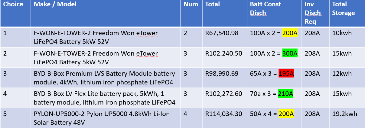

Very neat, I like it, but the cost … 17.5% higher than Pylontech for the same capacity. At 70Amp constant discharge I assume that I will need 3 x 4kwh batteries (104A x 2 = 208A required / 70A per battery = 2.976, rounded up to 3). Or is the 2.976 close enough to maintain warrantee?

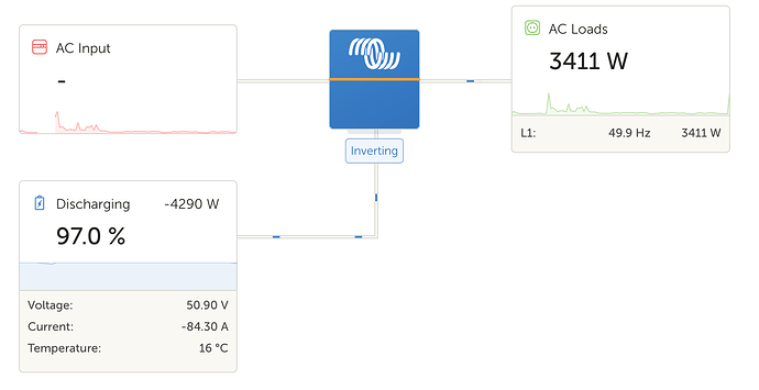

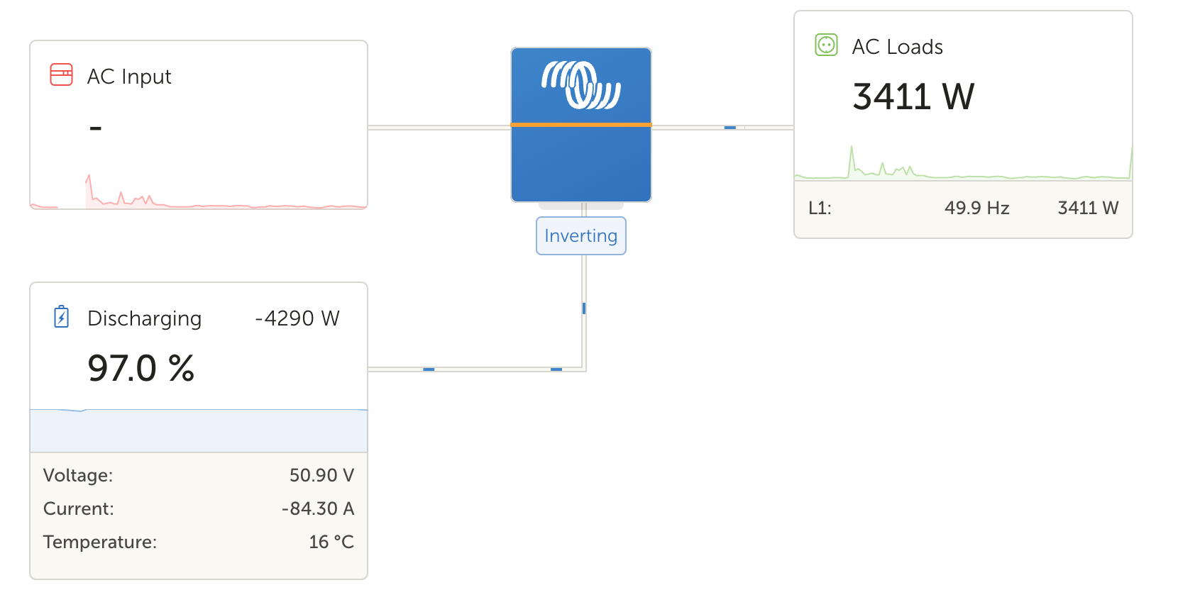

@Gungets - to answer your question on the continuous discharge of 70A. Here is some emperical evidence of my mom load testing her system… This is a Victron Multiplus II 3000VA, with a BYD LV Flex Lite 5kWh battery.
Does that mean a change to Venus OS which current has a static value in the loop for BYD?
In South Africa, it is the Flex Lite. Yes 70A is correct. Ie. Not a 1C battery and 2 required for a 5kVA.
You need 1 BMU per battery bank, whether 1 battery or 64.
The items you listed there are not for use with the Flex Lite, they are for the LVS and LVL which are a different - more expensive - Premium stackable (VERY COOL) product.
The Flex Lite can be placed on top of one another up to 4 high using pins supplied with each battery. You can also buy feet for the bottom battery OR instead buy a cabinet from BYD to make it easy to connect all 4 batteries into one bank.
BYD does not allow daisy chaining. Each battery must be connected to the busbar - IMHO, this is the right way. Daisy chaining a la Pylon is dangerous.

Vote Time, if I might be so bold. Green highlight is where the batteries satisfy or exceed the constant discharge requirements of the warrantees. Yellow where they are marginal, red where they don’t. My Scottish heart wants 1. My head another, but I don’t want to sway votes. Need to order latest Monday, and part with a seriously large splodge of wonga, so appreciate your participation.
The fewer the units, the safer it can run, the happier I am … I vote 2.
