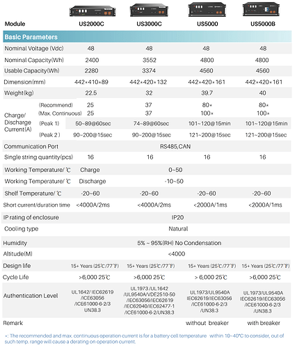

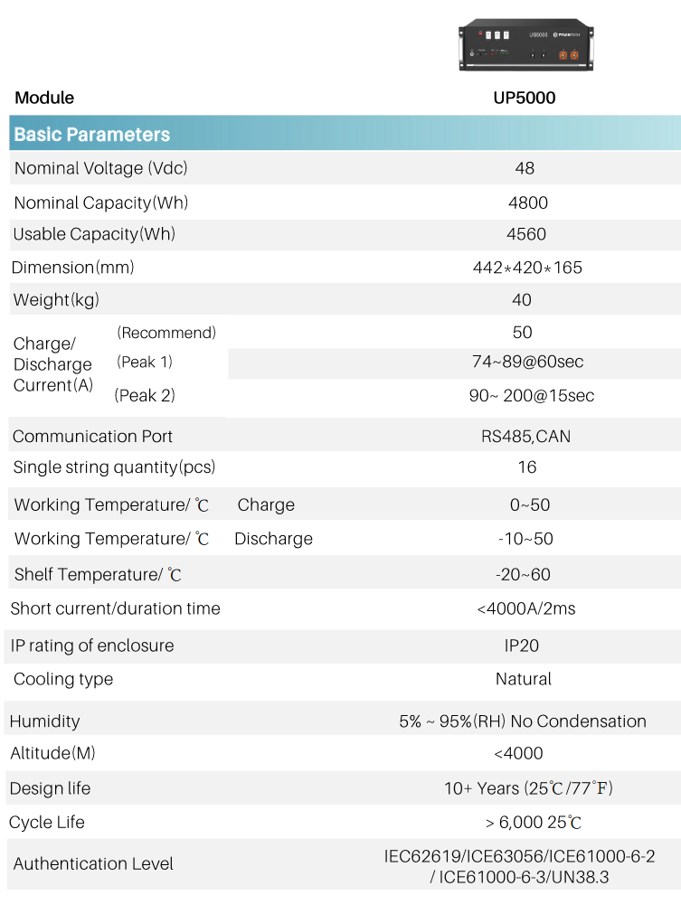

Doing some checking, the Pylontech US5000 (should that be UP5000?) has a continuous discharge of 80AMP. Would two of those then do the job?
Three would be better.
Breaking my dark Scottish heart and cutting into my Windhoek Draught fund, but it is still much better than 6 x US3000s.

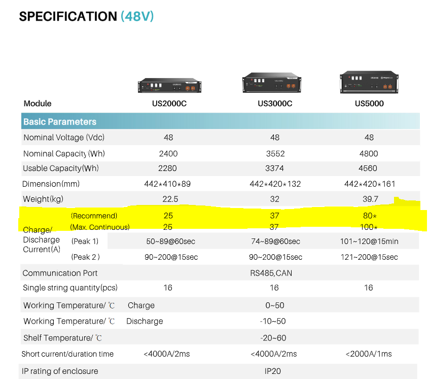

The US5000 is 80A continuous, the UP5000 is 50A continuous.
Edit: it seems the US can perhaps do 100A continuous?
I missed that, the US is not available in SA yet. it is indeed 50 amp on the UP5000… Nice work…
