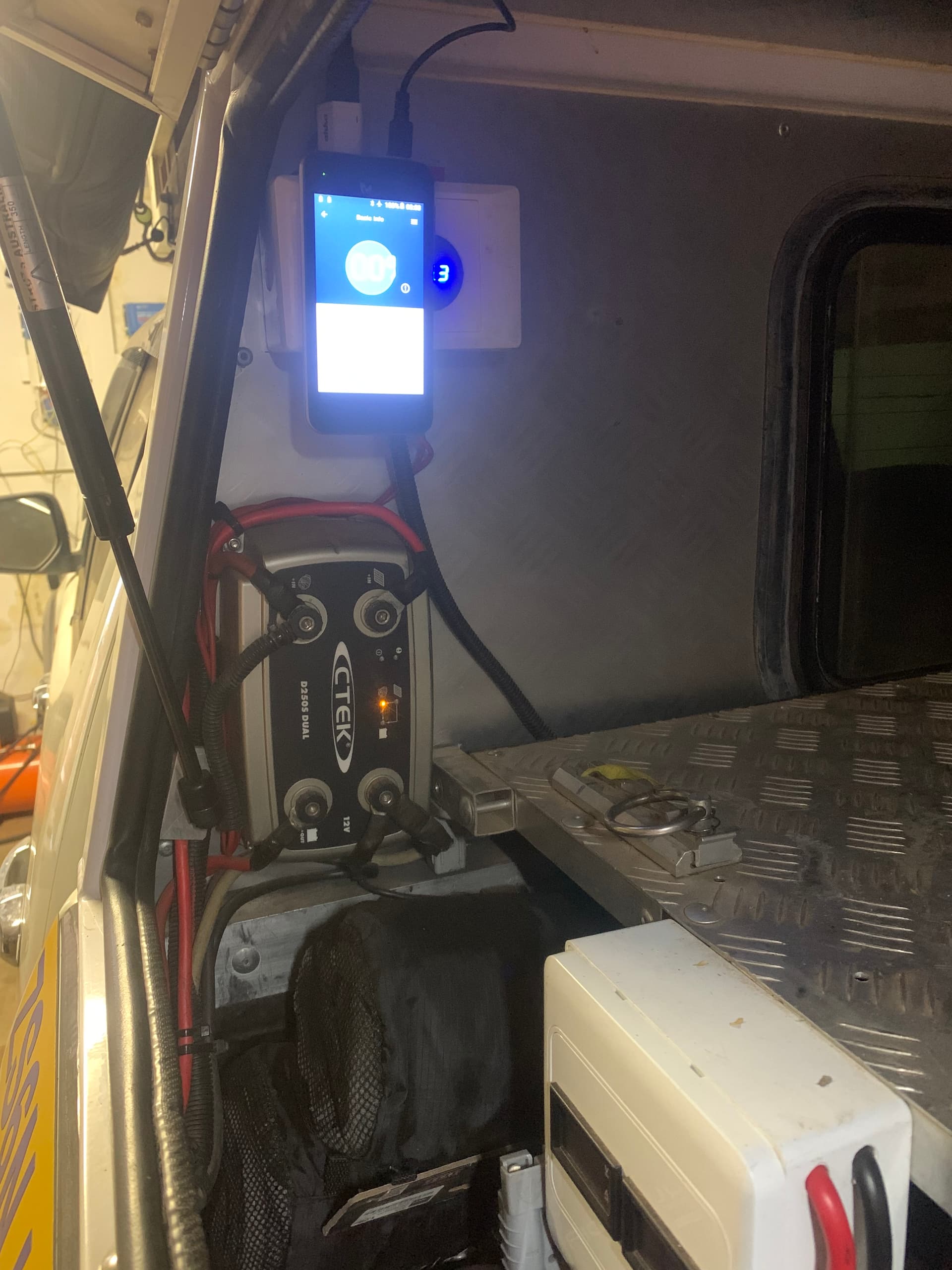

Here is mine in the canopy.

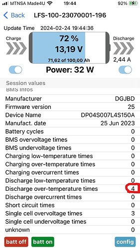

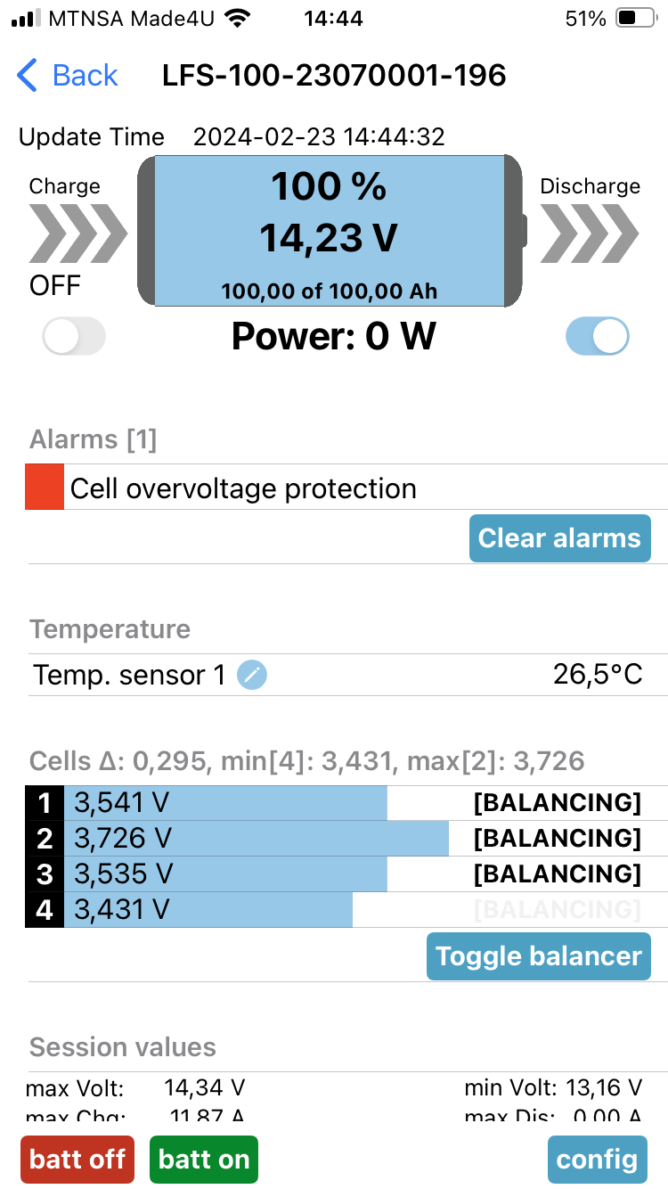

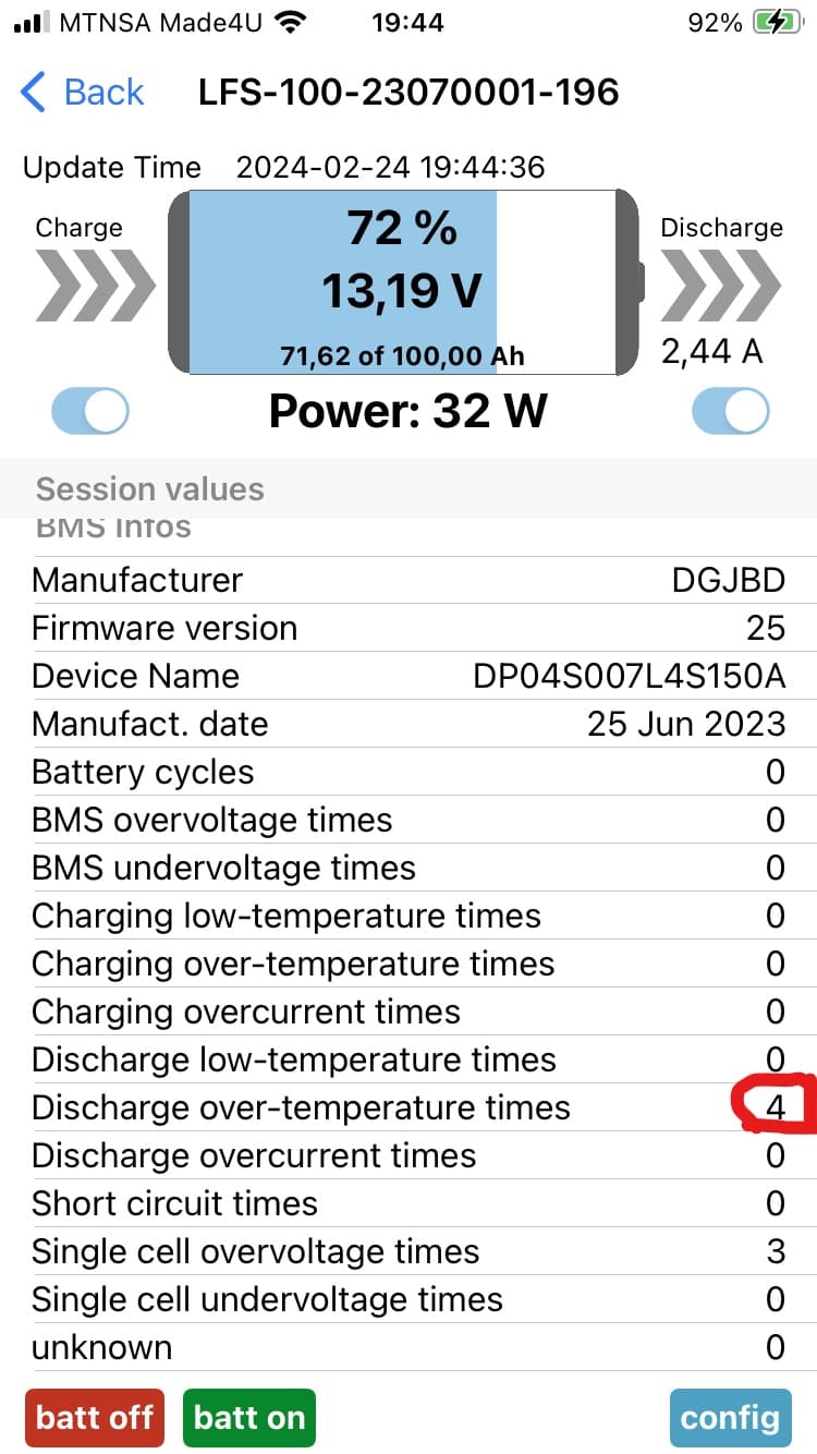

It seems identical to the Blue Nova, just different stickers. However, I do have a couple of concerns:
  • When I charged it for the first time on Friday it gave a cell overvoltage protection alarm a few times - the one cell voltage was a lot higher than the others
  • I’ve been running my National Luna fridge since Friday as a test and it has given a few discharge over-temperature alarms over the few days. Max draw is only about 4A.
  • Has a slight bulge on the bottom of the casing.
I am not sure if it may be an indication of a dud cell or night but it seems to be discharging OK and all cells are in balance. I’ll probably start a new thread here and ask the LiFePo4 fundi’s what they think. Will also log a call with Livestainable and see what their feedback is.

This does use a JBD BMS (from your screenshots), so that would be a large difference to the Blue Nova. The JBD is a nice BMS from my experience. It has a feature where you can tell it to balance the cells even when it is not charging which you can use the get the battery balanced before using it. So charge it till full. Then disconnect the charger and also the load and activate that balance feature and leave it for about 1 or 2 days. Disable that setting when done.
I don’t know the iPhone app that well, but on the Android there are 2 toggles for the balancing. If both are on then you are in this mode. If one is on and the other off it would be the normal mode. I think bedescribed it before somewhere in this forum if you want more details and screenshots.
