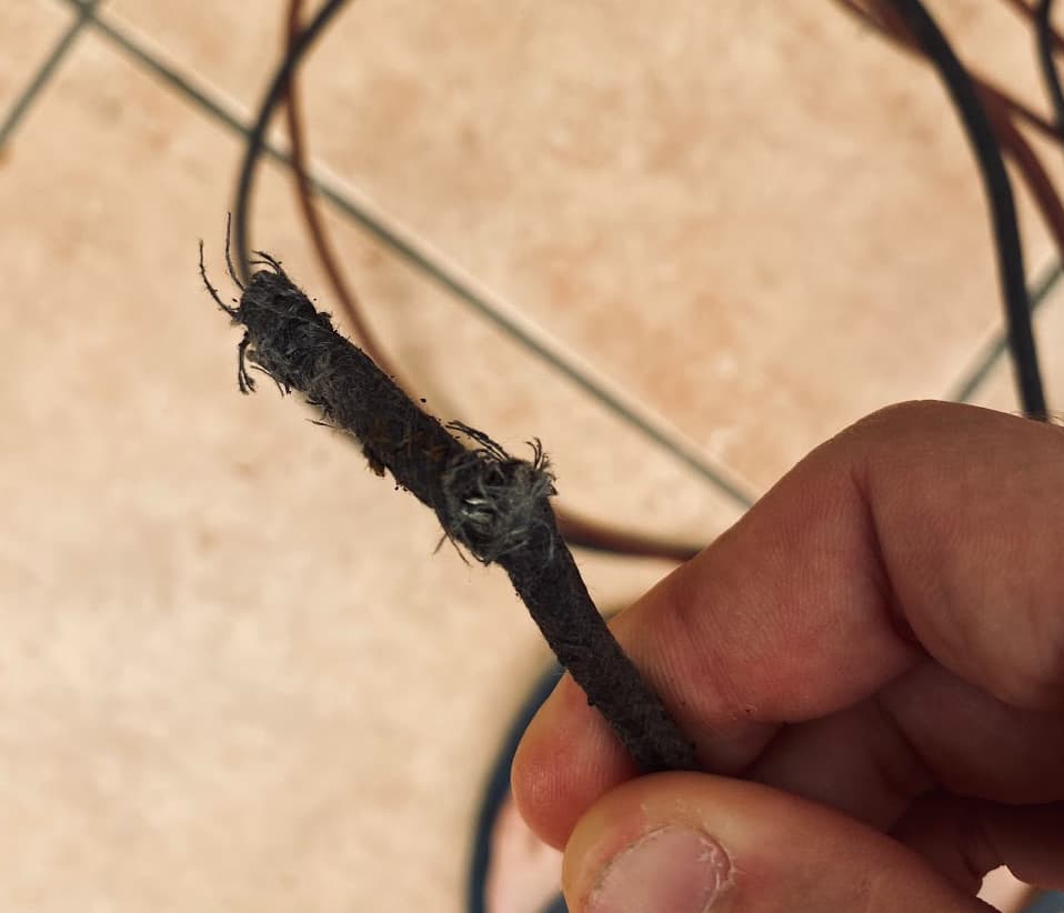

He found this (inside a metal pipe of course):
Nicely frayed neutral

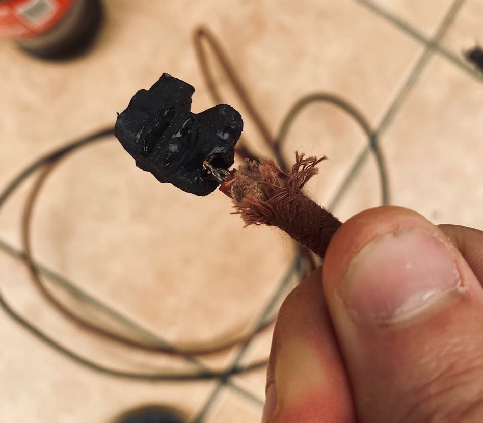

And a live connector with a rogue inner piece jutting out to touch whatever it likes.
Fingers (wires?) crossed that’s the last of it. Old houses…

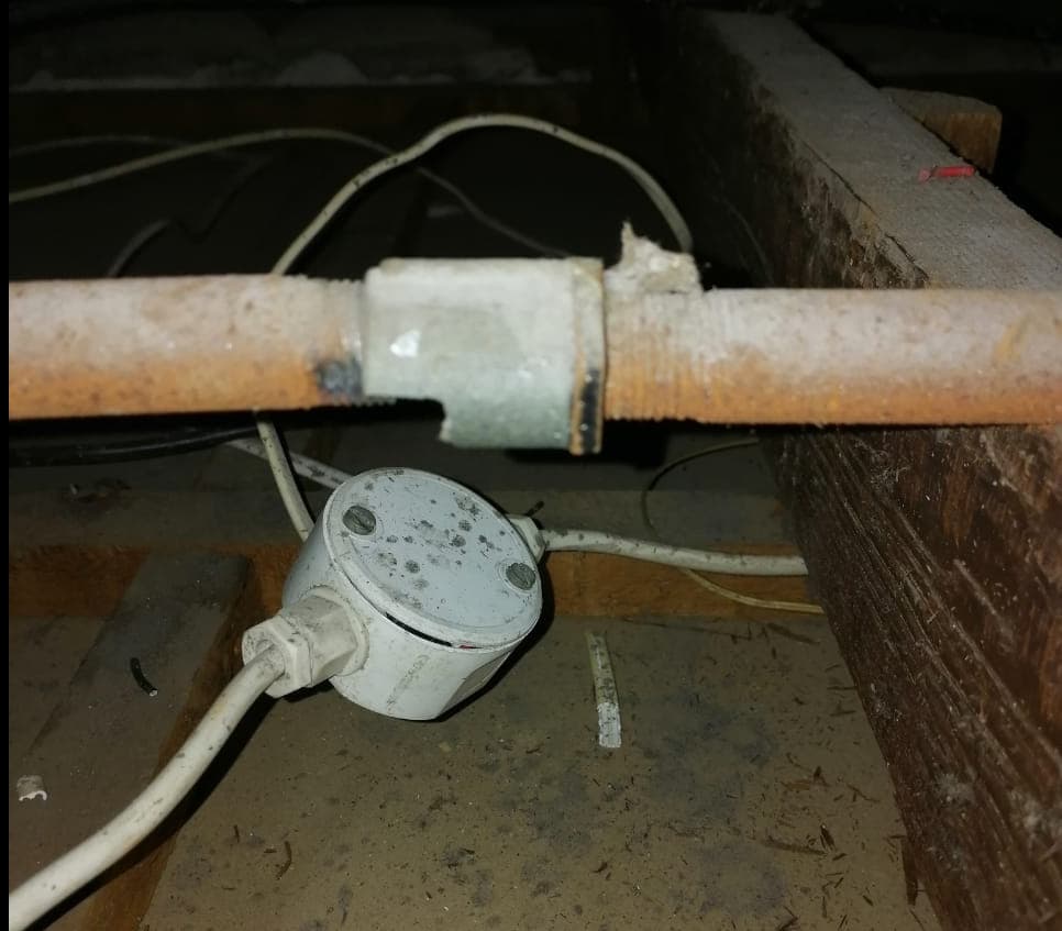

Electrician arrives, goes into the roof, tells me to connect the neutral. Immediately he shouts “I see it! It’s sparking!”
Turns out there was still one remaining cloth neutral in a metal pipe between 2 of the kitchen lights.
So that was feeding to ground, and the lights “worked”.
Replaced that neutral, all happy so far.
I believe I’ve now removed all paper/cloth wires from my roof. Fingers crossed that’s the case…
