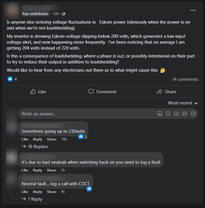

Any thoughts on this somewhat related thread on the neighbourhood FB yesterday? (the term “neutral fault” triggered my spidey senses somewhat)
In PE… I mean Gqeberha… family of mine lost the neutral to cable theft. Entire street was affected, their RCD was tripping all the time, and they blew up a garage door opener (the MOV inside did it’s job, and blew itself up, sadly it was not backed up by a fuse).
If the three phases are more or less balanced, the voltage divides evenly over the phases and the missing neutral doesn’t cause a complete loss of power. But if the phases are unbalanced, one phase gets 200V, the other one gets 270V, the third one gets 190V. In their case, they had >270V, cause that’s usually where the MOVs are rated.
