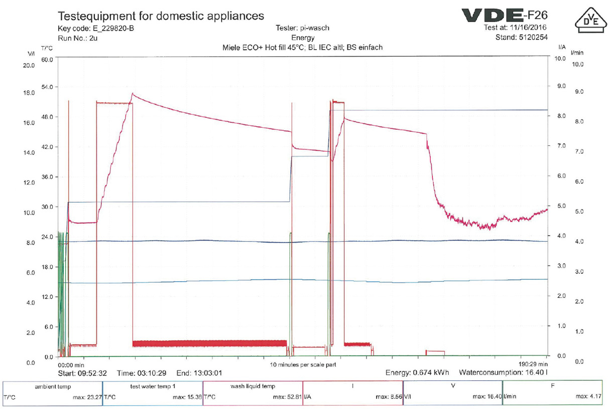

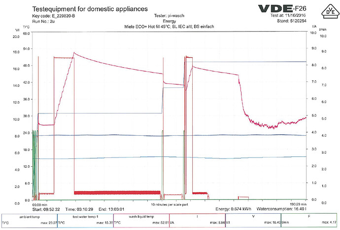

Adding “pre-heated” water might also not lead to nearly as much of a saving as one might expect on any but the newest/top-tier machines that make provision for it. Not very recent but still informative test cycle data on a Miele dishwasher (from a short report where some folks checked whether dishwashers pull a VW and adjust for testing scenarios).
The water during the machine’s “Eco” programme first sits for about 10-15 minutes before the cycle calls for water heating - i.e. there is a good chance that pre-heated water would have cooled down quite significantly and will still be reheated by the washer’s element (granted probably requiring less heating).
Unless the pre-heated source is very close to the washer and/or pipes very well insulated there is also the problem of whether any pre-heated water will reach the washer. I know most warm water outlets in my quite compact home take at least 3-4L water before warm water emerges. On a cycle with 10L TOTAL water consumption I will therefore likely only add 1-2L “preheated” water per fill.
If switching to pre-heated water - remember the inlet pipe you received with the machine is very likely only rated to 25oC.

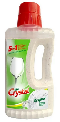

I do the same! We use this product:
Selection_608
If you fill the cap to just a little above the halfway line, it fills up the dispenser and leaves a little bit left that you sprinkle on the door. That makes the initial rinse a little more effective.
