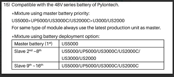

According to Pylontech batteries should be arranged from newer model to old, i.e. 3 x UP5000 first, followed by US2000. Excerpt from the UP5000 manual:
Make sure they are all at a similar charge level before connecting them together. Whenever I add a new battery I always charge it up separately before connecting it to the existing stack. The manual says this:

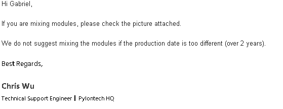

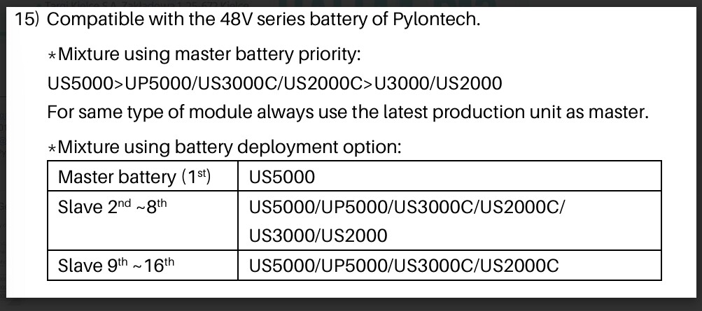

Regarding the mixing/placement of Pylontech batteries there are those who say you must ‘sandwich’ the older ones between the new ones, yet according to Pylon manuals you place the lates/strongest one as master… and then there is this img of an email I received from Pylon themselves as well as the img they sent…
