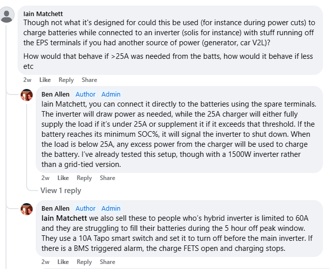

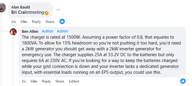

I have a Goodwe 5048D-ES and I’ve been informed it wont allow charging of batteries via a generator
My technical experise is poor hence I would appreciate it the knowledgble experts on this forum can confirm that this charger if powered by a generator would in fact allow charging of my 4 x US3000 batteries.

Have a look at Ben Allen’s facebook page there are a couple of interesting questions and replies, a couple of screenprint from a reply. I repeat my technical knowledge is rather lacking
