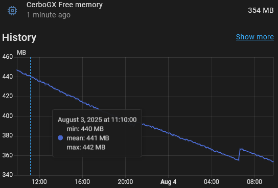

Once done the reloads stopped but I noticed that Free Memory on a constant decline. At some point I think it will either run out and reboot OR it’s like Windows that takes memory for caching and releases it when needed. Below I have some stats of the Cerbo.
The first little hiccup (under the popup) is where I disabled Modbus and the second one is where I stopped my pvoutput.org script. It made no significant difference to the trend.
Below is a capture of free memory over time:

Should I be concerned as this happened after the Venus upgrade to 3.6x. 3.5x was stable. Unfortunately I don’t have the same stats on the Venus.
