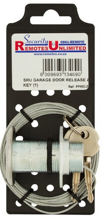

Another edit: I had to cut a hole through one of mine, to fit one of those backup locks for when the power is out (because no easy access otherwise)…
That thing is quite solid!
