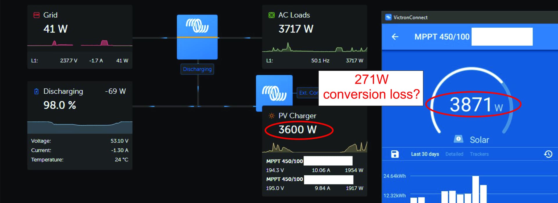

Anyone know how much conversion losses are to be expected between PV input and battery output i.e. MPPT and DC to DC conversion losses?
I noticed on Victron Connect the available Solar power shows around 271W higher than the PV charger power shown on the dashboard. Not sure where these measurements are taken but assume it is on the PV input side vs. the output side of the MPPT RS 450/100. That is around 7% loss. Seems a bit high.
When running at lower power say 360W the loss is around 1.5%

97% (ie 3% loss) is a best case scenario, and what most marketing material will claim. You will see this on some PV inverters, but it also typically assumes operating at 25°C.
The MPPT RS you have has a max efficiency of 96%.
Ambient temperature, the input/output voltage ratio, and power level also affects the efficiency of all DC/DC converters (which is what an MPPT is).
You’re seeing about a 7% loss, which is not indicative of a problem.
Edit: Remember also that the measurement isn’t perfectly accurate either, that can also be a off by a few tens of watts.
