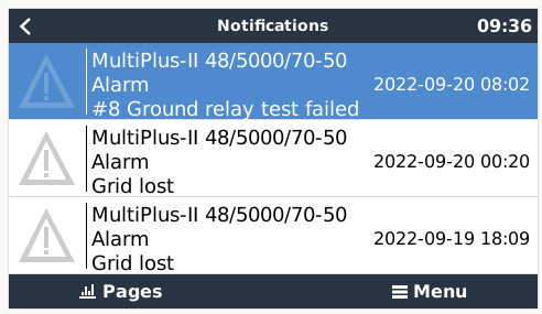

With the original Multigrid installation years ago, when Eskom comes back on after LS, the Multigrid will switch off on the spot. Each and every single time.
As we did the official tests, the sparkie found that the earth from the street box was nowhere near to specs. Asking the Munic to fix it, not a chance.
So they had to install a spike, that long rod thing, hammered into the ground, next to the house, and connect that to the earth of the DB. The Multigrid worked perfectly thereafter.
I was told, and the form reflects the same, that it is a TN-C-S connection now.
Test one concluded:
First Grid lost, was me doing a quick test.
The 2nd one was also me, off for one hour, with the same everything as this morning.

At this point in time, having removed any chances of any “foreign voltages” between the main DB / inverter for this LS cycle, the breaker is switched off.
Let’s see how this one rolls, this morning it took 5 minutes before the first error, now 42min in, no drama yet.
Perfect, worked as designed … if I switch the breaker off.
Will do that for a couple of LS events to make damn sure.
Think I need a solution to disconnect the DB from the street when Eskom goes off.
And keep it disconnected for 5 minutes after Eskom comes back on.

With the breaker off since 12am this morning, I got one again this morning …

Have you considered the possibility that the relay might actually be bad?
I did, do, consider that.
But for that it needs to go in, and with the influx of issues lately, parts shortages, not forgetting LS, it is going to become a rather serious exercise.
Wish there were loan units one could use whilst it goes in for service/repairs.
So before it goes in, I need to make 100% absolutely sure it is definitely the unit, and not something else.
While I generally think you should not be doing that, I cannot see that causing this particular issue.
I think you may have to consider that the relay is actually going bad. The firmware is doing its actual job. You may be able to get it swapped.
