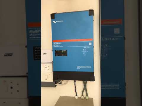

So the new warranty exchanged inverter is installed.
Man, I’m SO glad of the new mounting, it made the swap out a breeze.
The trunking is perfectly still in place.
YES!!!
Now let’s see how this new one behaves … a few months at least … the syncing sounds totally different.
In the normal relay test, it does one of the tests twice (checking relay K4), but now it doesn’t have to do that anymore. So it should sound a little different. I’ve never heard it though.
A YouTube video would be interesting to hear the new relay tests.
This is mine recorded:
After the relay test, it takes around 2-3mins to sync and another relay “click” :slight_smile:
You should be able to hear roughly 8 clicks. There are 5 relays involved in this (4 on the newer inverters), but some of them are switched on simultaneously during that step, so won’t be audible.
If you ever have the opportunity to hear a PV inverter, you will hear the same.
The ABB/Fimer is fairly fast, but not as fast as the Multi.
The Solis absolutely takes its time, with about a second between each step.
The Fronius is very quiet, you basically hear only the big contactor pulled in at the end.
Sounds like my “old” one … new one sounds differently. At least, I thought so.
are you able to record and upload to YouTube?
I am very curious :slight_smile:
