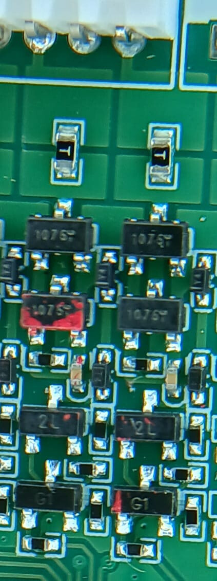

It started reading a low voltage on the first cell:
Poking around, it looks like one of the transistors in the mux switch for the pin is toast:
Still trying to find a reference for that 107 [S5]? transistor to see if I can replace them. From the layout, it must be a N-channel MOSFET, but the closest SMD marking I can find is a dual BJT.
