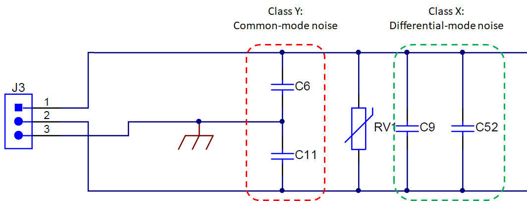

In modern houses the biggest cause of nuisance trips are the class Y caps in SMPSs that connect to earth. (and surge protectors, that have essentially the same arrangement.) The solution is RCBOs.

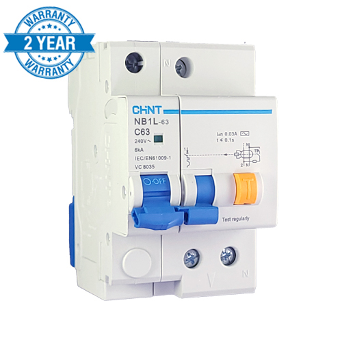

RCBO stands for Residual Current Circuit Breaker with Overcurrent Protection. It’s a safety device that protects electrical circuits from overloading, short-circuiting, and earth leakage currents. RCBOs are a vital component of electrical systems and are installed in consumer boards or fuse boards.
An RCBO protects electrical equipment from two types of faults; residual current and over current. Residual current, or Earth leakage as it can sometimes be referred to, is when there is a break in the circuit that could be caused by faulty electrical wiring or if the wire is accidentally cut.
Basically combined RCD and breaker. You have one of them for each circuit instead of a breaker and delete the main RCD.

It will be a bit expensive to redo the entire DB all at the same time, but a interesting option.
