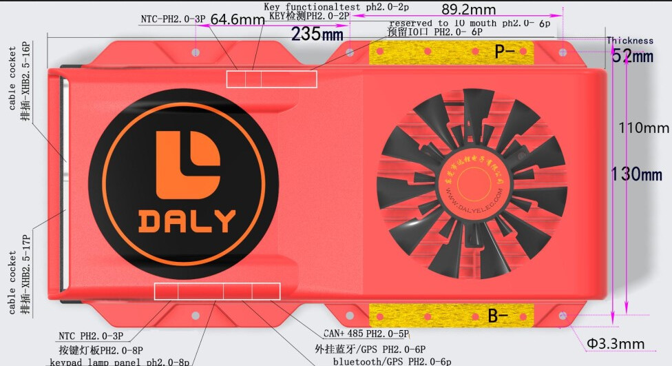

Replace the Daly … I’m onnit … the new one is coming with allegedly (negotiating from Eng to Chinese back to Eng is a challenge) with a CANbus, Bluetooth AND UART PC port.

I think @justinschoeman is using the new smart Daly with the communications. It’s comms protocol looks very close to what my BMS use and it does look very capable, but I have not tested/used it.
My BMS is the same brand as the new one that TTT has bought.
Have asked the Daly manufacturer/supplier: What are the max operating volts?
For this BMS: SMART BMS LifePo4 250A 16S common port with uart/RS485/CAN communication
It is still max 60v.
They also said, the Daly I have, can only have “charger for 58.4-60V”.
Upon mentioning the 72v spikes, they said: That’s why there is causing huge problems for u. I suggest you choose a larger cells than 16s of BMS, otherwise same issue would happen.
I instantly liked the ones @Louisvdw pointed out to me, maybe having made a mistake due to translation, I MAY get one without a UART port, if not, @justinschoeman said maybe there can be a CANBus connection, to which end I asked for the CANBus port to be Galvanicly isolated.
In any case, the older version could do 85v, the new ones max 73v.
