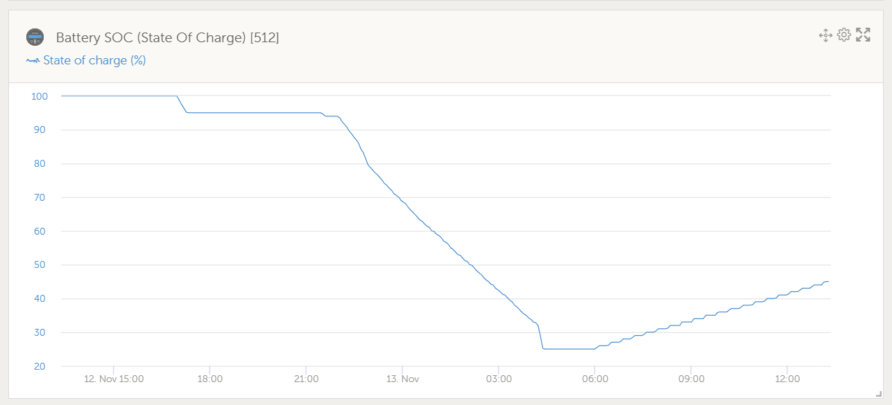

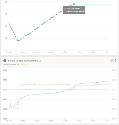

It’s common, when the SOC gets out of sync. The logic inside the BMS wants to see a certain cell voltage before it will allow the SOC to be estimated higher than a certain amount. It all has to do with the flat voltage curve of LFP. Below 3.4V, it does coulomb counting, and if the SOC is really far off and the BMS didn’t have the advantage of also knowing cell voltages (eg, when using a BMV), it would count to 100% and then continue to charge past 100%. But with the knowledge of the cell voltages, the BMS now caps it at 88% and waits until the cell voltages match.
I know OrionBMS calls it “drift points”. Specific voltages known to correspond to a certain SOC. I’m sure other BMSes do the same.

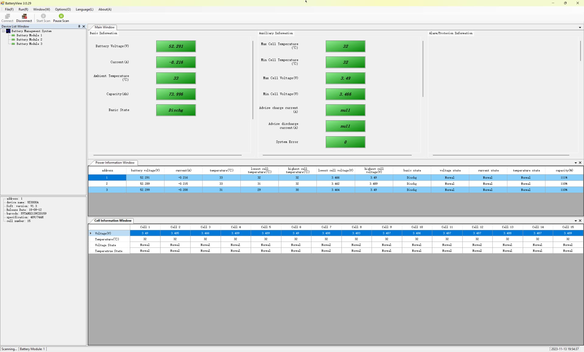

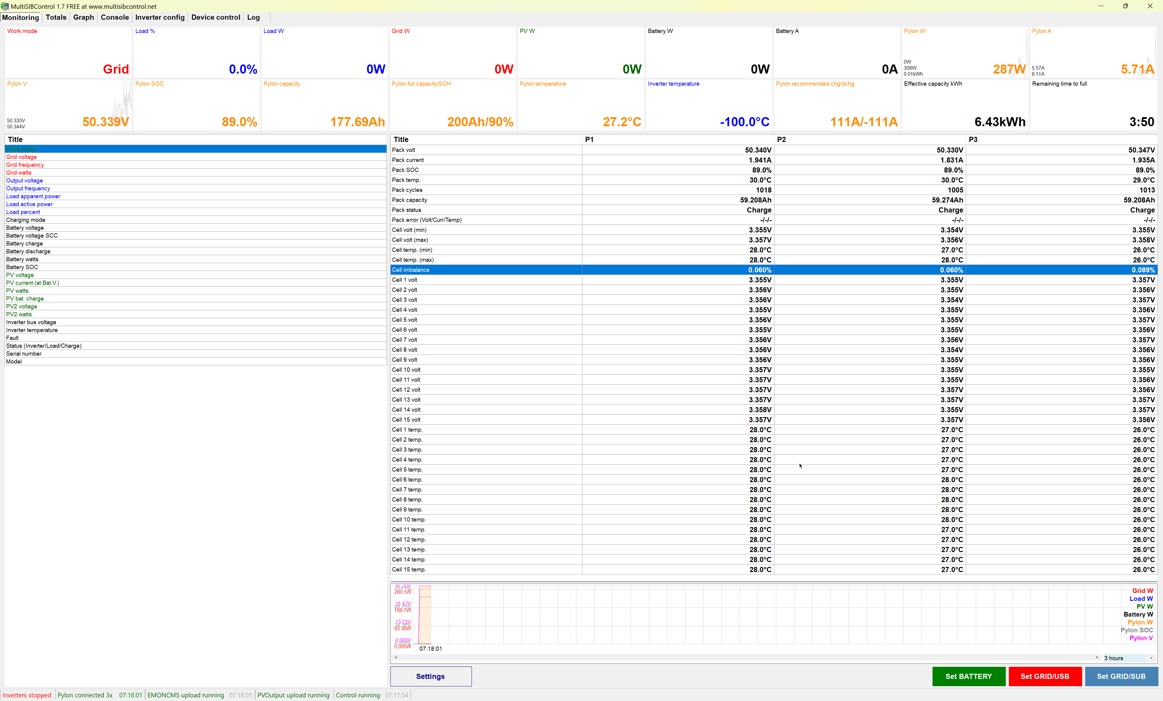

Finally got BatteryView working (@#%*&@# premade store-bought cable). Had a look at the 3 US3000A’s while around 70% SOC and sitting idle - nothing abnormal observed. Temperature and voltages across all the cells looked fine:
Battery 1: 70% SOC min cell: 3.289v max cell: 3.292v
Battery 2: 72% SOC min cell: 3.289v max cell: 3.292v
Battery 3: 69% SOC min cell: 3.289v max cell: 3.292v
Started charging again at 5A, 52v, will see what happens when the BMS balancer kicks in. After a couple of mins:
Battery 1: 70% SOC min cell: 3.297v, max cell: 3.302v
Battery 2: 73% SOC min cell: 3.297v, max cell: 3.299v
Battery 3: 69% SOC min cell: 3.297v, max cell: 3.300v
No abnormal voltages that I can see - yet. That being said, my high-voltage warnings were fairly intermittent and not “permanent”, so may not see anything for a while.

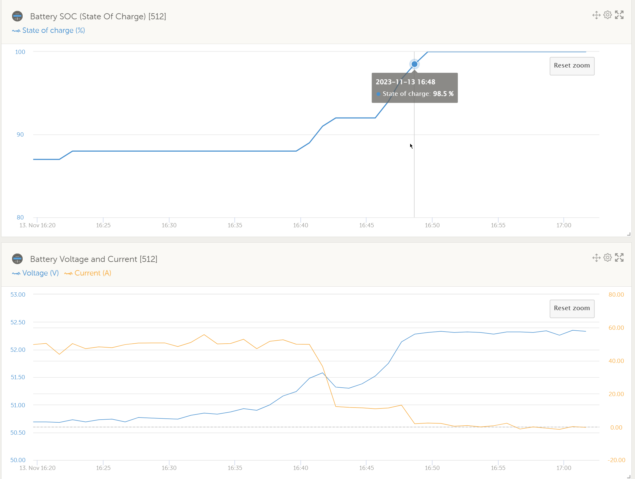

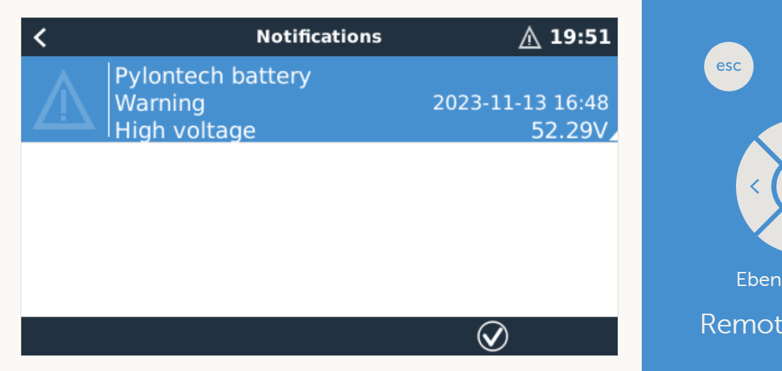

I followed @Louisvdw’s advice and recharged the batteries at a higher speed (50A) with the intention to drop to 5A around 75% SOC again. Of course I got busy (meetings) and ended up charging them 100%.
Any thoughts? Is the error reported by the Pylontech as a warning, which is then logged and displayed by the VenusGX, or is it the Venus’ interpretation of the battery voltages?
If it is on-battery, is there a way to get a log and more detail, or do I have to be there (logging away) to catch it?
