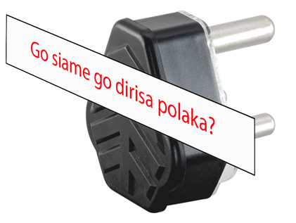

another idea from the Five Rand store… Have the gardener check every time if it is okay to use the electric lawnmower. Put a notice on the socket where the lawnmower is powered from that requires intervention before use (like “remove before flight pin/tags” on aircraft).
Use a babyproof plug cover or unconnected plug with a laminated label glued to it. (to be reinserted after mowing the lawn).
