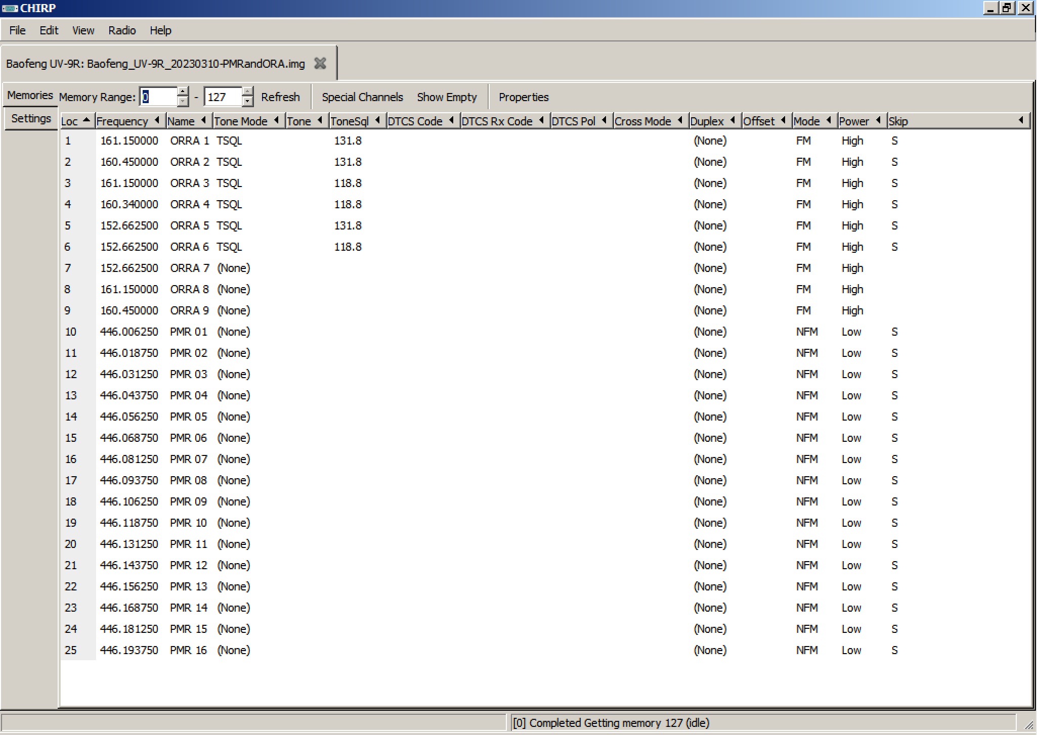

Nice, mine also arrived yesterday. Already programmed both for 16x PMR channels with low power output and 9x ORRA channels with high power output. Works well. I definitely heard no one else in my area on any of the channels, except for noise on PMR3.

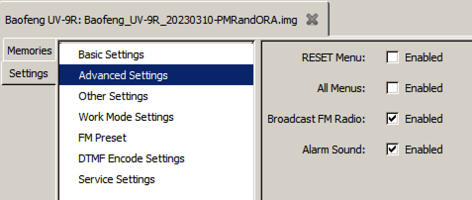

Since I have a kidā¦who does all kinds of things to devices, I also disabled the reset and menu items completely.
Channels:
Menus disabled:

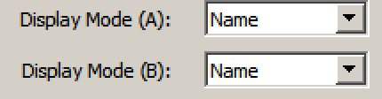

And to see the channel names on the display instead of the frequencies:

Thats correct yes.
First I had to order https://www.takealot.com/uv9r-programming-cable/PLID73200166 and 2x radios.
Then you need to find the drivers for your OS, was abit of a mission on windows but it was some CH341SER drivers I found to be working.
Then you download the Chirp software from Home - CHIRP which can program a bunch of different radios, including these.
Makes it a 1000 times easier to program, though its possible using the radio keypad too if you want to go through that crazy long process to program many channels.
