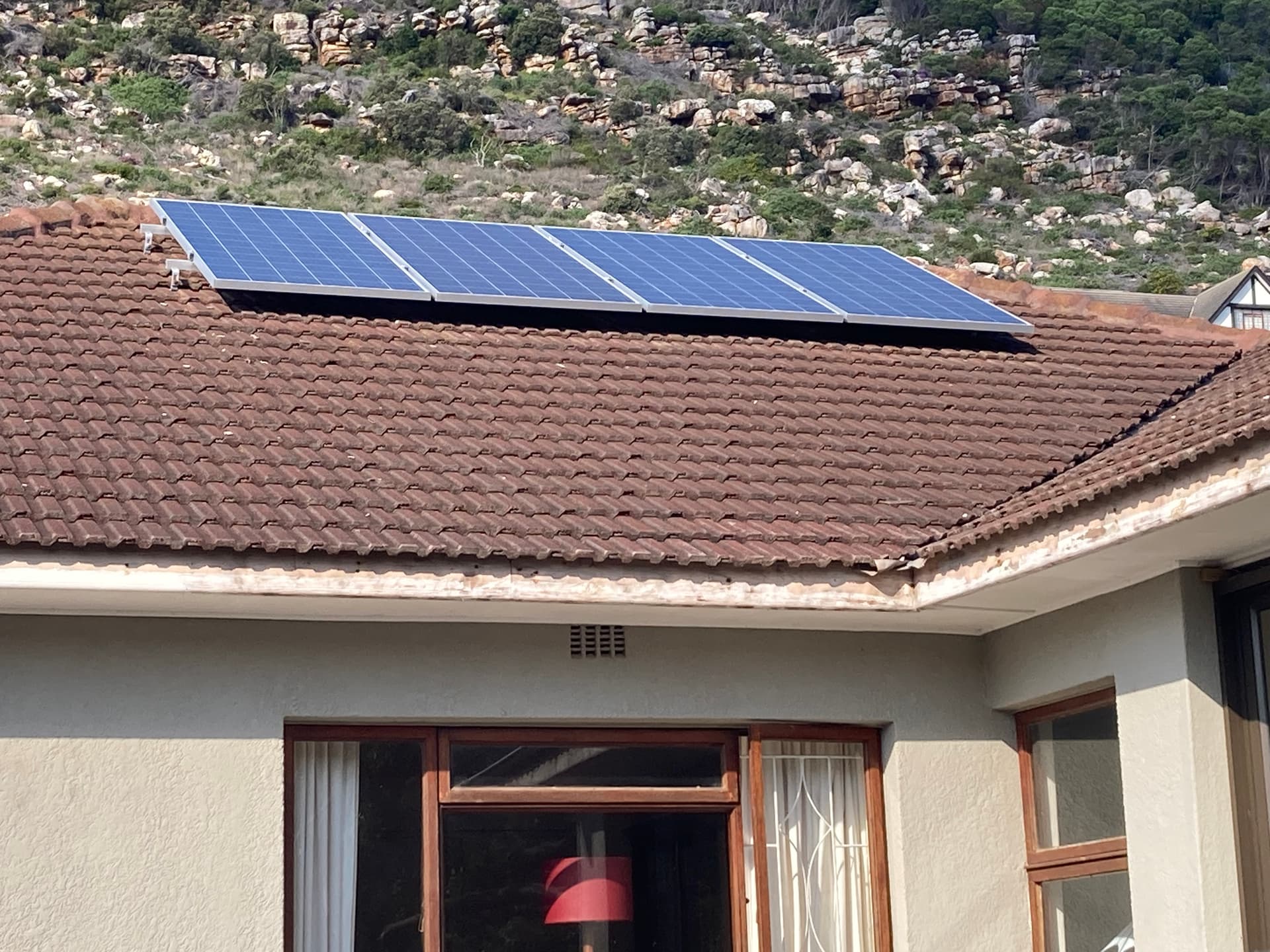

So I’m consequently happy with my 4 dedicated PV panels powering my geyser with 1kW approx as long as the sun shines and also with no inverter hammering away!

If roofspace is not an issue, then maybe heating water with dedicated PV modules is an option, for the simple reason that it is a less expensive than a heat pump, takes less maintenance, and will probably last longer.

Just a point on this water heating issue: This stand alone system doesn’t switch on/off. Only if it’s a scorcher of a day will it reach the 75°C cutout. So it’s on all the time.
So if you incorporate this load into your intelligent load control mix you still have to provide for it. and it’s probably your biggest load.
