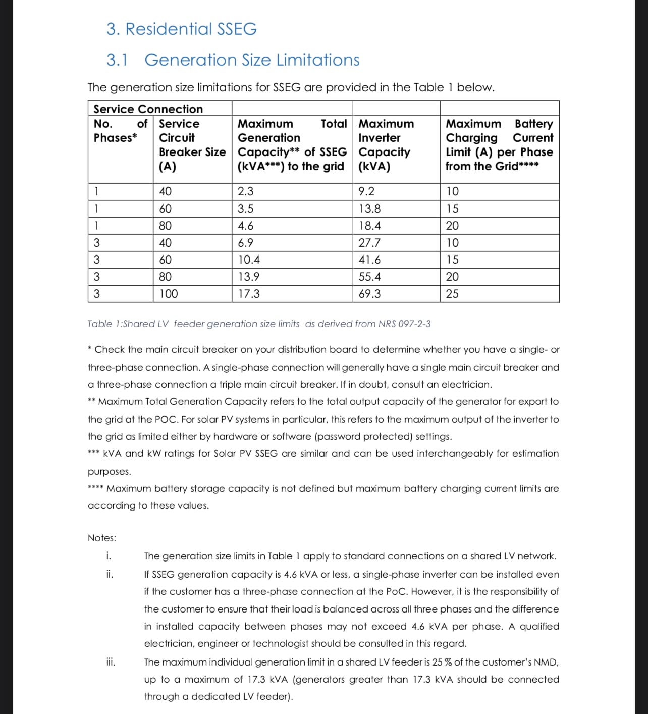

The battery charge current limit is 25% of your main breaker size, so for a 60A supply that is 15A. You do not need to limit it with a breaker though, since that would cripple your passthrough.
The exact wording in the CoCT “Requirements for SSEG” document is:
Maximum Battery Charging Current Limit is 25% of the circuit breaker size of the
customer’s service connection, as per Table 1. This limit must be specified on
the inverter’s serial-plate or if software adjustable, the setting must be password
protected.
I go the password-protected, software adjustable route.
So 25*230/50 about, or 115A. Since the 5kVA can only charge at max 70A, you’re hardware is already within the required range.
It’s 25% of your main breaker size, not a fixed 25A, but your point stands: With a 5kVA MP2 there’s no need to worry about CoCT’s charge current limit, since the inverter cannot exceed it.
Oh! Of course. Well, let’s do that math again then. For someone with a 60A breaker (most of us on single phase connections), that’s 15A then, times 230V, divide by 50-ish. That’s 69A. Multi can do max 70A (and it derates pretty quickly anyway), so you’re still completely safe.

Many people staying in estates have three phase power. Then the total incoming current is at least 120A if I recall correctly.
The limit is 25% per phase, so if you have a three phase supply and a single phase inverter then you’re still limited to 25% of the main breaker size. However, if you’re lucky enough to be able to afford a three phase inverter/charger then you’re effectively allowed a maximum charging current of 3 x 25% = 75% of the main breaker size.
Well, actually, it is still 3 x 25%, as you have to have a 3-phase generation. You don’t get to put it all on a single phase.
I don’t see that the inverter capacity is limited in that way, only the generation to the grid.
This is now updated regs, but in the old regs, the inverter size was the limitation on single phase, not on three phase. These days they have clarified.

I was referring to the maximum charge current - the last column.
This wasn’t part of the old regs though.
Ah yes, CoCT splitting up the limits into generation, charging and export was a major step forward. Initially they didn’t allow you to have more than 3.5kWp of solar panels on your roof if you had a 1P 60A supply. That was depressing.
