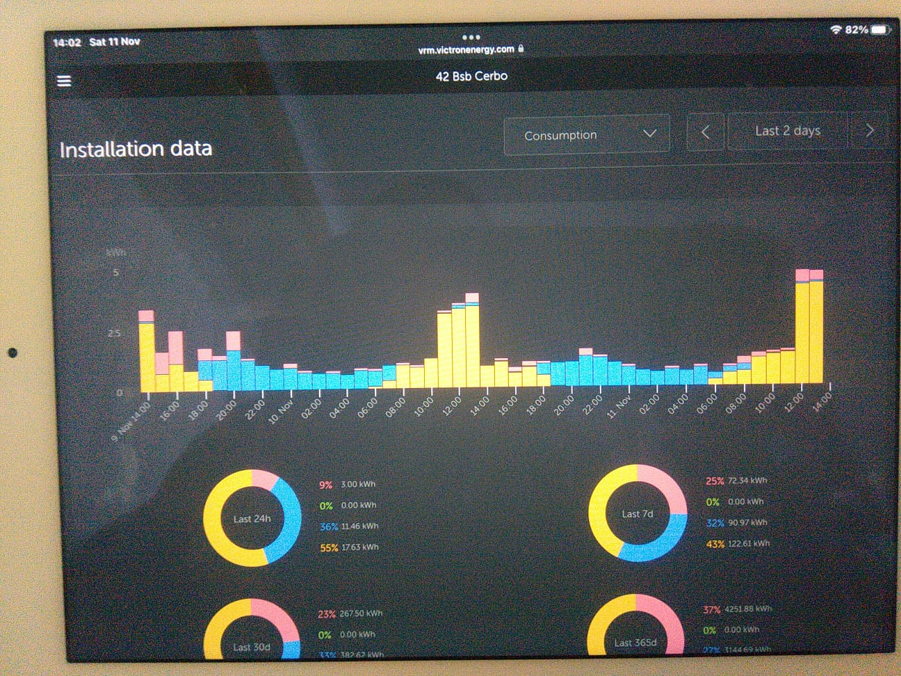

System, as is, is balanced … if there is sun: 8 people and 3 geysers - managed

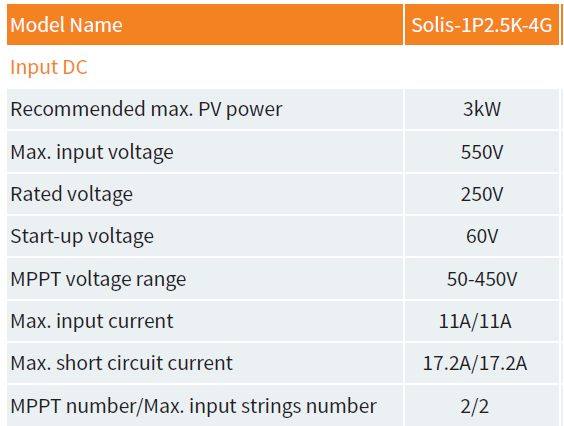

Update on all we spoke of above… have a Solis-1P2.5K-4G now:
  1. Just waiting to hear about the panels I want to fit … if it can, or only 500w panels max.
  2. Solis will be fitted to the main DB, with a Carlo.
  3. LS is easing in Cpt, if it gets really bad, can fit Solis after the Victron.

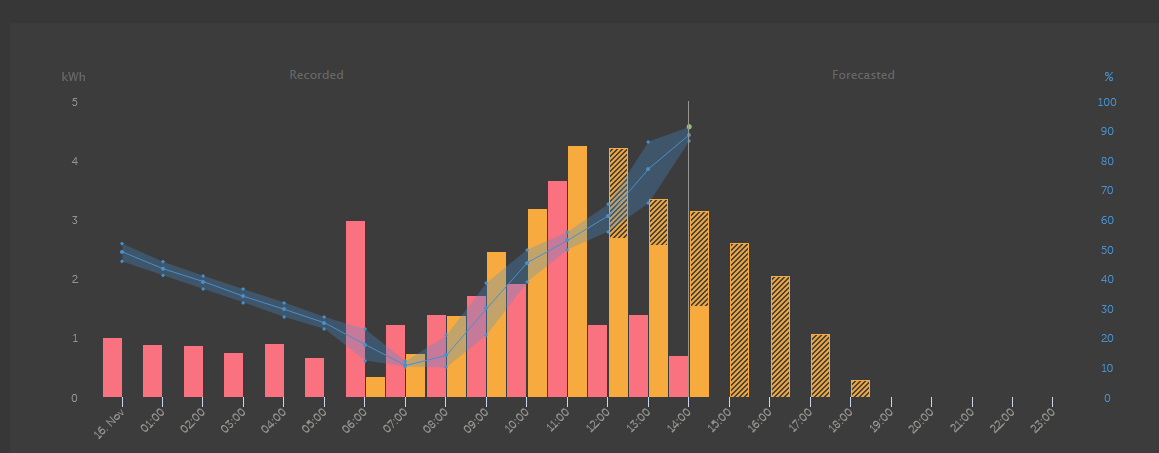

Fwiw, my 500W panels made their first real power today, using the 2kW Solis that is similar to yours. Still wired somewhat ghetto at the moment (PV inverter just shoved into a plug), but recorded a nice 1.6kW around noon, from 2kWp of panels, which are not optimally angled (rather, aesthetically angled).
I recharged all the distance we did with the EV today entirely from the sun.
Plan for this is pretty similar to yours. Get house battery recharged by 2PM when the EV comes home. After that, there is enough PV to recharge the car fully by 5PM.

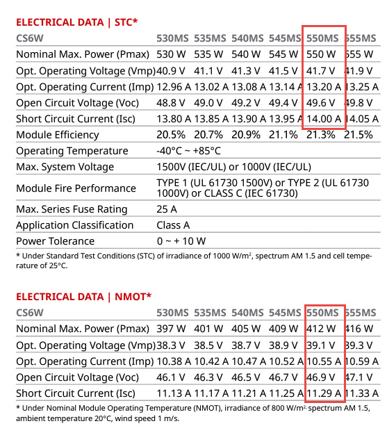

Solis says these panels are spot one …

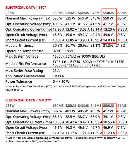

These panels: CS6W-550MS-N-FRAME-T6
Canadian Solar 550W Super High Power Mono PERC HiKU6 with T6 and New-Frame Length
Monocrystalline
Now I’m known to buy and then have I see the corner I’m in … there is more than one model of 550w Canadian panels - hence the question basically.
What am I missing, if anything?
I have the Solis mini 2000 , 600V max input, but limited to 11A (17A Isc).
I got confused. I THOUGHT I have Canadian Solar, but it seems I instead bought JA Solar. Funny. I little cared so little about the brand that I didn’t even look.
The Imp is 13A, while the Isc is just under 14A.
If I look at the Information screen on the inverter, it seems to be pegged at 11A most of the day. Multipplied by a Vmp of around 38V, explains why I’m only getting around 1600W out of the lot. That’s about 80% of the installed capacity. Practically verified :slight_smile:
Based on the NMOT values, it seems I accidentally got on the right track because of your post, and @Anton’s confirmation.
… and very happy I asked Solis to confirm it is indeed the right track, seeing as the Canadians are sometimes different from other brands. :wink:
