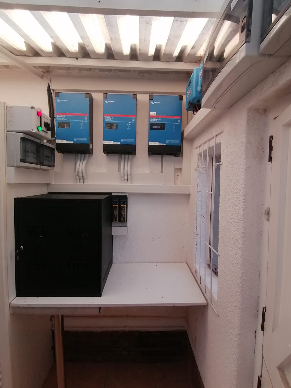

Congrats @MongooseMan, and a job well done to @JacoDeJongh

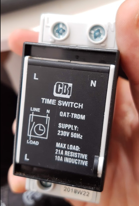

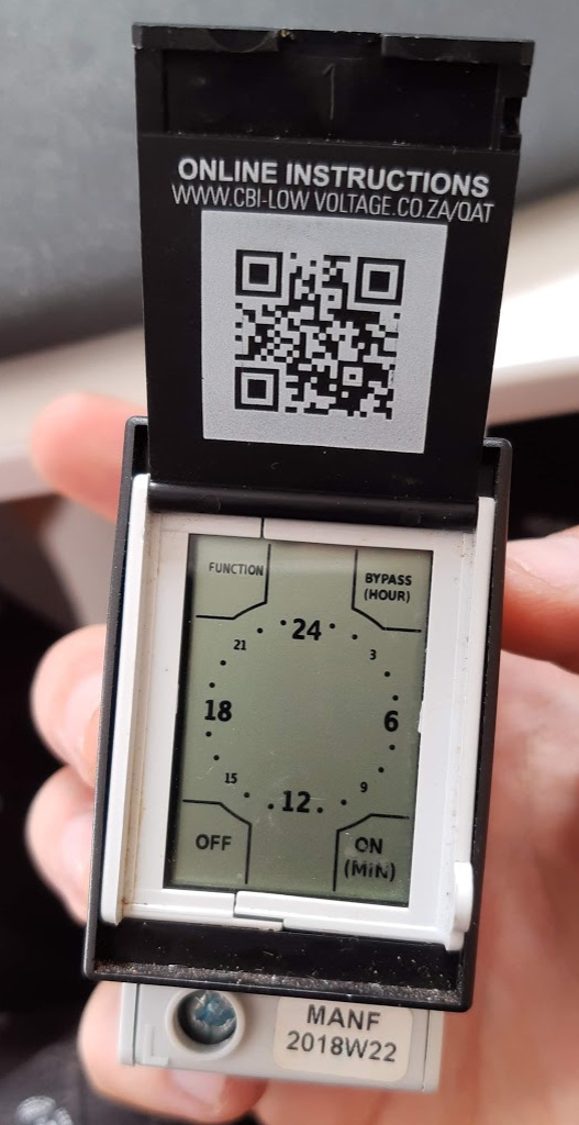

Will probably just use this for now, since I have it lying around (stole it from the pool pump when I put a Sonoff Pow on there).
Will at least sort out the scheduling until I can do a “smart” solution
CBI has come out with a new timer that has built in wifi, called the Astute timer, fits both DIN and MINI rail
I assume that’s the one @gbyleveldt is referring to?
Pity it doesn’t seem to link to Home Assistant.

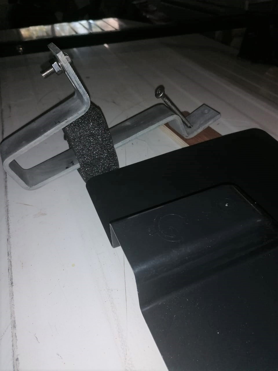

@JacoDeJongh did you use dowel screws into the roof?
Hi Mark I used these kits:
It contains a 100mm screw that get holds the bracket to one of the main trusses, you use the little piece of wood for a spacer, cut the top tile to allow the black plastic part to slide under it. Then lastly you would seal the entrance with the sponge part.

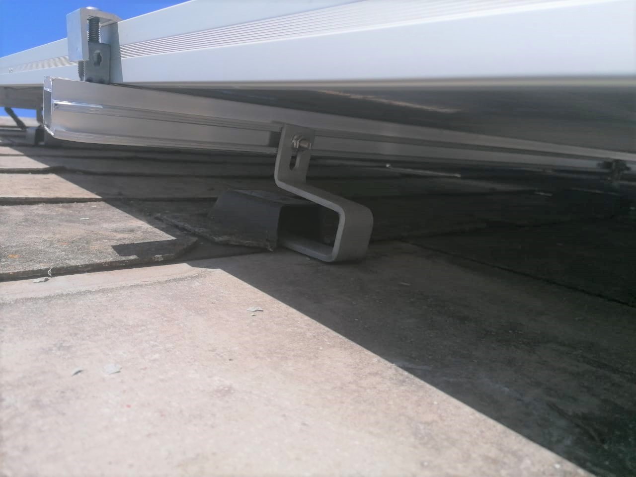

The end result looks like this:
Looks good. I do like the plastic water “stopper”
Also you can run cables through there as well…!

That looks awesome! Much congrats. Heard about your roof tiles. Luckily when they got to my roof, they had a lifetime of experience as we have the same tiles. Not four layers though
. Went considerable faster as I only have 8 panels.
Mongoose man that is one hell of a system! Very impressed.
With regards to that particular timer, what a peace of crap. I went through 2 in less than a year as it also starts to malfunction.
The touch screen is rubbish, its backup battery is crap and it is notoriously difficult to program as opposed to other timers.
Get something else. Or wait and prove me wrong.
