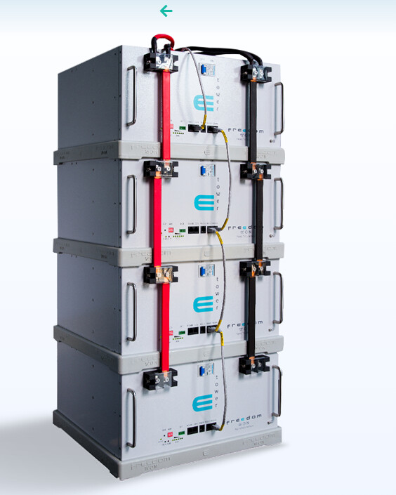

HI sorry for a negative comment. From what I see there is that you would start running into imbalances a few months from now… I don’t know what this look like at the back. But I am missing at lease one positive and one negative wire.
Top left is the issue. It need to be in series with the rest - not a big issue to fix. If you are using 2x pairs of battery cables to the inverter then make sure about how they are wired.
For example below - the postives should be wired to the bottom battery.
Yes, hence the comment for the Lynx with equal-length cables.
The ETower marketing is pretty terrible as it’s made to look neat and not practical. From what I recall, they say if 3 or more batteries, then they need to be wired top and bottom. But the first prize is connecting them all to a common bus.
It looks to me like the one stack on the left goes to the busbar.
Then the single batt on the right is ready for the 2nd batt there, going to the busbar.
Hence the potential of the single batt getting unbalanced if you take too long to get that 4th batt?
(… more motivation …)
Or … rewire them as 1 x 3 batts in parallel if it takes a while for the 4th module.
If there is a bus bar at the back with the way it is set up now, it will be fine.
To expound on that: the issue with lead acid is that they can pass significant current after they are full (while boiling their electrolyte). If you have even small amounts of differing impedances in the paths, it makes a difference, because the internal resistance of the battery (while charging) is relatively low compared to the total path resistance.
Lithium, on the other hand, stops accepting charge when they fill up. So much so that we need balancers to help the current past the high cells, otherwise they would never balance. This phenomenon also helps us when they are in parallel. If one of them fills up first, it stops accepting charge, and the other modules (which are not full yet) gets the rest.
Therefore a slight difference in cable length is not going to kill you, especially not if the battery is fully recharged daily or at least weekly.
Not a license to be sloppy, of course, but I don’t see a particularly huge issue with the above. I do however defer to two other things, 1) installers with more experience with the product, and 2) whatever the manufacturer says you must do.
