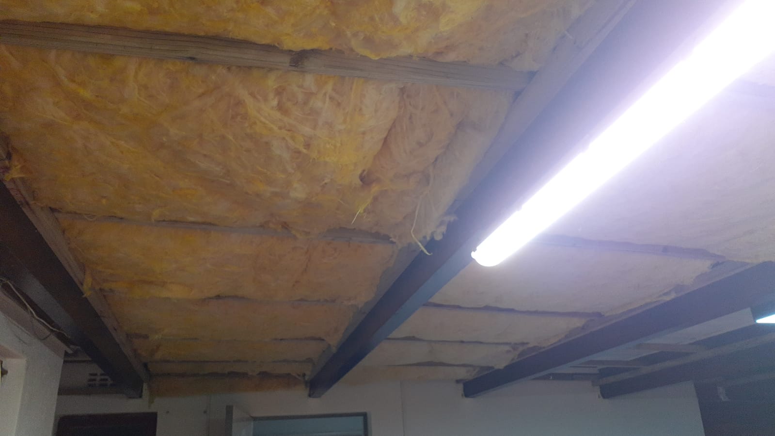

First roll was tough to, 2nd one easy:
  1. Challenge One: Get all the wires above the insulation.
  2. Challenge Two: In the middle of the roof their is a beam, insulation must go under it.
  3. Challenge Three: Beams are 1.1m apart, it helps if your son is a trained fit stuntman. Daughter who said she can do what he can do, yeah boet, she got a real big “workout”.
She made the mistake of saying: Geez, this roll is heavy! (getting it from beam to beam not touching the PVC ceiling.)
Son replied: Men don’t complain over shiite like that, toughen up buttercup and get moving!
… I nearly fell off the ladder laughing! :rofl:
Tricks we will learnt:
  1. My sons idea, we use thick planks to kneel on, sit on. Keep them near the trap door for easier getting in. Got the idea 12 years ago when we pulled the UTP wires in. We use 2 planks, one to sit on, when moving the 2nd one forward. Safer too. Less strain on the body.
  2. The part to get a 5m roll under a beam … roll it to the beam, then cut it, roll the rest of the way.
  3. Do NOT do it when the sun shines … no need. You need a touch in any case.
Now the next 11 rolls can come …

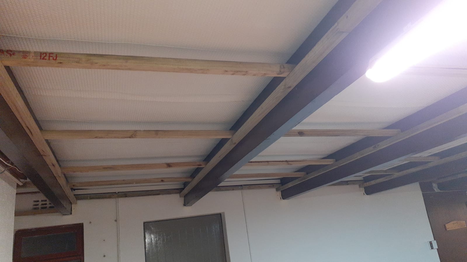

We accidently got that when we replace the roof yes.
Product called Alububble. It is a type of vapor shield too if fitted correctly. Now I know why they fitted it the way they did - the vapor shield part.
Can see white side of the Alububble in the first pic above the batons.
So underneath the Alububble, the 135mm Aerolite now.
Aerolite same R-Value as Knauf at half the price.
This the 3rd roof I’m doing. This one we got clever.
The Trick I figure:
Previous roof, had to cut the aerolite to fit over/between the batons, both roofs being flat.
This time … the batons in first pic, not screwed in yet. We could easily take them out one by one, put the Aerolite over the baton, push the baton back in position, then the screw.

Before:

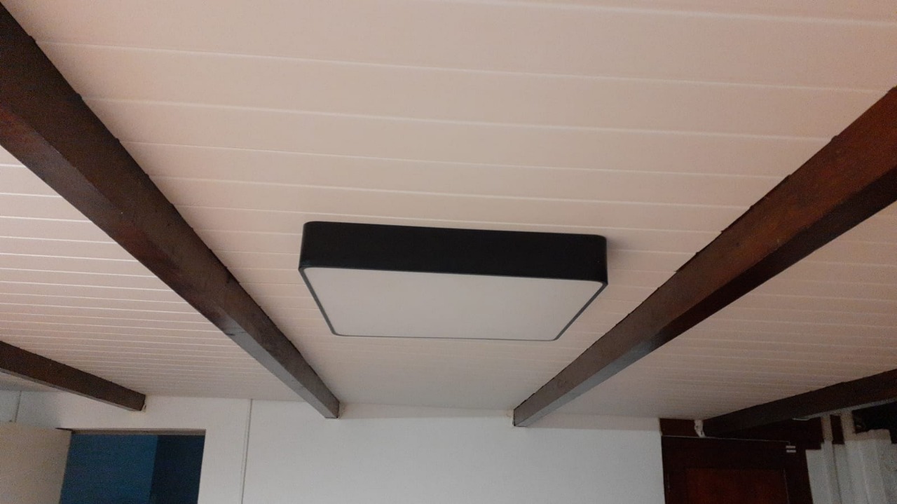

After:
With the white sheets to keep the sun reflected.
The Alububble underneath the sheets as a vapor shield and heat reflector back into the room.
Then 135mm Aerolite.
PVC ceiling to cover it neatly
Will see how this will works the rest of winter.
Third time’s a charm “they” say.
Thought I share as I posted the before …
Done … just cornices left to fit where needed.
That’s what I want - How thick is the PVC ceiling…?
Did it 135mm “thick”, measured from the roof sheets, for the aerolite to fit above it.
PVC ceiling itself … ±7mm thick.
