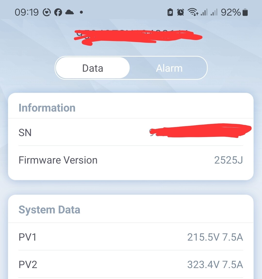

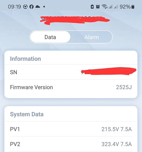

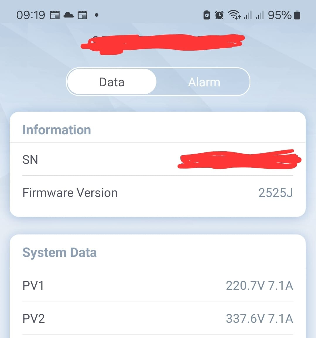

This morning we had actual sunshine. Hoorah. And look at the production:
Both strings working. Nearly 4kW at that time of the morning.
I leave the app on my phone running whilst I brush my teeth etc. And then I get this
Look out the window. The weather hansn’t changed. Sun is still nice & bright. Battery is at 95% so still would like some charging. What’s going on?
Ah. There’s an error. “High DC supply” at 9:24.

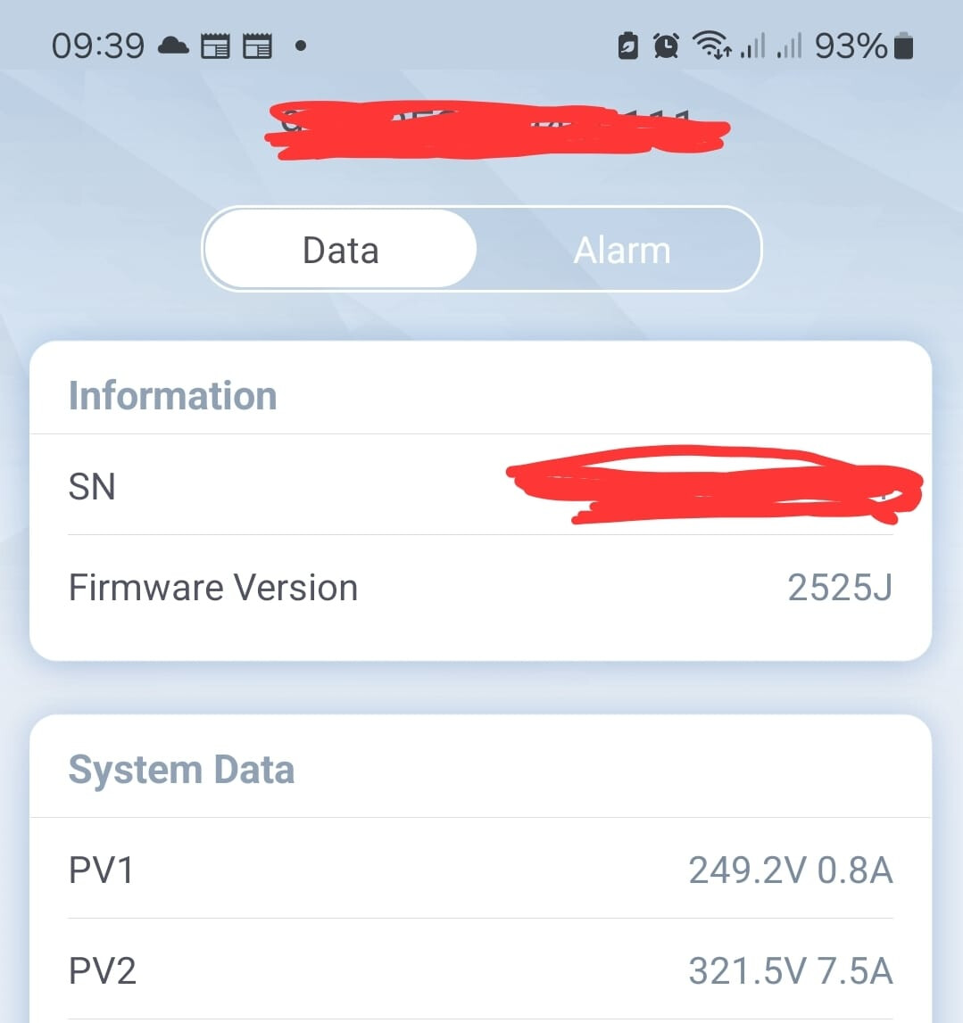

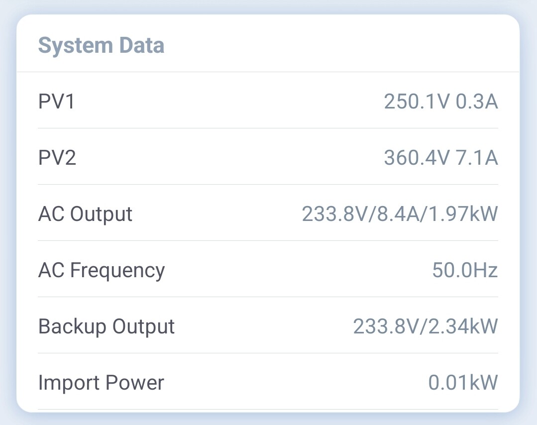

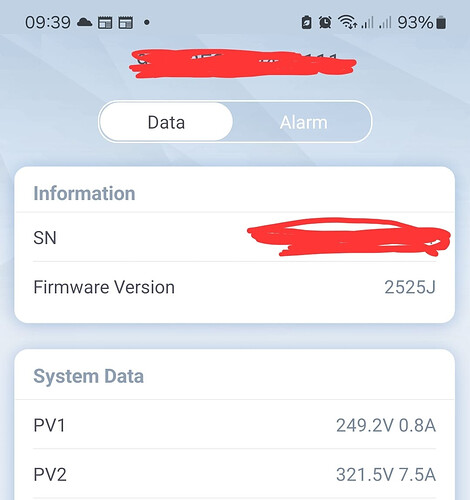

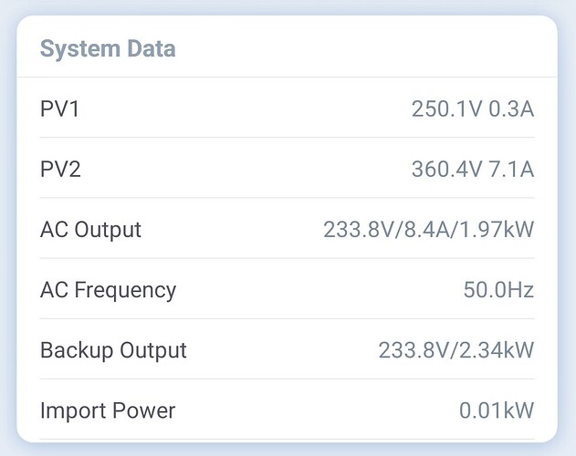

The current drawn from the panels continues to ramp up, but slowly. By 10:00 the system is running full tilt again. The battery charges, the system cuts back because now it just needs to service the load.
I check back in the logs. The earliest occurence of that message I find is in March, before the panel https://energytalk.co.za/t/i-need-some-work-done-quotes-please/5424/49upgrade.
Serious? IDK. After all the system recovers. This afternoon when I switched the kettle on it ramped up the draw from the panels again, with most of the juice coming from the North facing string.
This morning’s production is making me think that the glass might be as little as 1/32 empty.
Battery was charged by 9:40. Dishwasher now running and with less load to service the inverter is paying little attention to the N string (5*585 panels)
