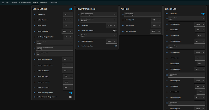

I am not much of a UI builder so I have built my dashboards from bits and pieces I found all over. Busy documenting and adding them to source control so that other people new to the scene can re-use them… They will also be part of my bootstap that will be free for anyone to copy and change them. The learning curve for newbies to HA is quite steep

It looks good so far! The reason why I only allow editing after clicking on them is that it just becomes too easy to change settings by whoever has access to HA!
Can still probably take this one step further by “Locking” the option to write settings to the inverter.
The images I posted above was the standard setup under the device (Settings->Devices&Service->Devices)

HI, I love you dashboard. I was trying to get the same look. I’m already running sloar-assistant connected to be DEYE 8KW inverter but I’m battling to get what you have.

I have this below which is the one thats created automatically which is cool but I really like yours.

Ok let me just paste something to get you started
I was hoping to release the first version but then life happened and I will be offline for another 10 days due to a hiking trip.
You need a couple of frontend HACS plugins too
plugins needed:
slider-entity-row
layout-card
The easiest would be:
three dots… Edit Dashboard, then add a new empty tab… then three dots… use the Raw configuration editor, scroll down and locate where the yaml is for that tab… and paste the contents below into that tab (copied straight from the raw yaml)
Save…
Then you need to change all the entities to match whatever your system uses
thanks so much that really helped me. I just need to rename the entities but at least i have the shell now. It’s the furtherest i’ve managed to get. It seems as if solar-assistant MQTT HA integration differs somewhat and complicates the entity names that it exposes. for example on the Deye “time of Use” is called “Use timer” in Solar-assistant. They aren’t the same as on the inverter. I also can’t find the time slot options that are normally under time of use. That could just be me being dof. I still have a lot to play around with and see if i can figure it out.

I just realised that I defined “home assistant time entities” for these in the configuration.yaml as the datetime objects need to be translated back and forth to the inverter format and home assistant format (done with automations)

your configuration.yaml (to define the entities that you will edit via the screen and store a time value)
input_datetime:
timezone1_time:
name: Timezone 1 Time
has_date: false
has_time: true
timezone2_time:
name: Timezone 2 Time
has_date: false
has_time: true
timezone3_time:
name: Timezone 3 Time
has_date: false
has_time: true
timezone4_time:
name: Timezone 4 Time
has_date: false
has_time: true
timezone5_time:
name: Timezone 5 Time
has_date: false
has_time: true
timezone6_time:
name: Timezone 6 Time
has_date: false
has_time: true
Automations: (that will copy the values from the inverter to dateTime objects( in home assistant), and when the user edits the time, it will convert the time to the format the inverter expects and update the inverter values
