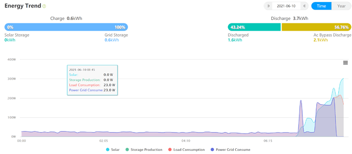

Time for a test again today (since we are load shedding and the sun is out in Jhb).
Settings are:
  • Voltage Point back to Utility (if available) = 51.2V (3.2 per cell)
  • Voltage Point back to Battery = 54.4 (3.2 per cell)
  • Bulk Charge = 56.4V (will change to 56V, balancing is happening at this point as well)
  • Float Charge = 54.6V (will see what happens if I set this to 55.2V)
  • Low DC Cutoff = 48V (highest it can be)
I can see that the solar production is currently enough to drive the entire load and also push a little charge into the battery (not that it’s needed at this point, but at least the battery is not drained like I saw earlier this week).
For reference, this is the graph for today (so far):
