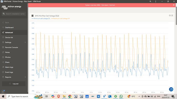

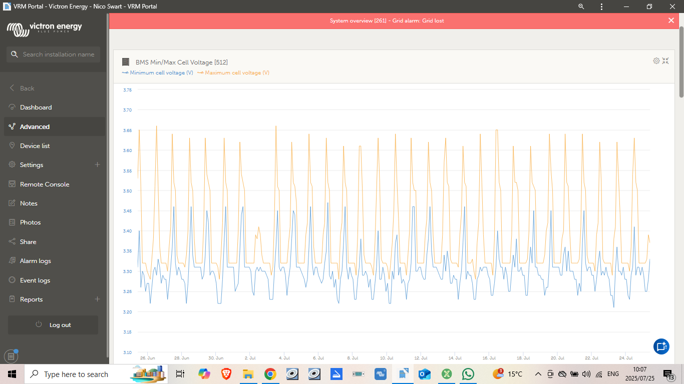

Don’t want to start a new thread seeing as I also have the E-Towers.
Not sure how to interpret the graph, but to you guys in the know, does my min/max cell balances still look to be within acceptable ranges?
The battery is pretty much full when all the cells are above 3.45V. There is less than 1% left to be had at this point.
It is also normal for your highest cell to jump out once you reach this point.
So when the high cell is touching 3.65V, while all the rest are above 3.45V, that’s a good place to be. Ideally I would like to see them creep closer over time.
The difficult part here is that we don’t have all the data. You could have one cell at 3.45V, 14 cells at 3.55V, and one cell at 3.65V. Or you could have 15 cells at 3.45V and one cell at 3.65V. The former scenario is of course preferable over the latter.
You can somewhat estimate what is going on, with some simple math.
With the lowest cell at 3.45V, there are roughly three scenarios.
  • 15 cells at 3.45V, one cell at 3.65V, pack voltage = 55.4V.
  • 1 cell at 3.45V, 15 cells at 3.65V, pack voltage = 58.2V
  • 1 cell at 3.45V, 1 cell at 3.65V, the rest somewhere in the middle, 3.5V, pack voltage = 57.3V.
Depending on the pack voltage, this will give you an idea whether you are dealing with a high cell, or a low cell.
I seem to recall that the BSL battery, the cousin of this one, charges to no more than 55.4V. So you have a high cell. Nothing wrong with that, but ideally, I would over time prefer to see the lower cells pull up, or at the very least, not drop out even further.
Much obliged Plonkster, thank you for this detailed explanation!
Is there something I can do to maybe assist the other lower cells to catch up as you state?
Maybe play around with the pack voltage? Lower it a bit or raise it a bit?
I am on 85% SOC now. I should be full in about 30min time and will then make sure to what voltage the batteries are charged. If memory serves, I seem to recall this to be at about 55,8V
