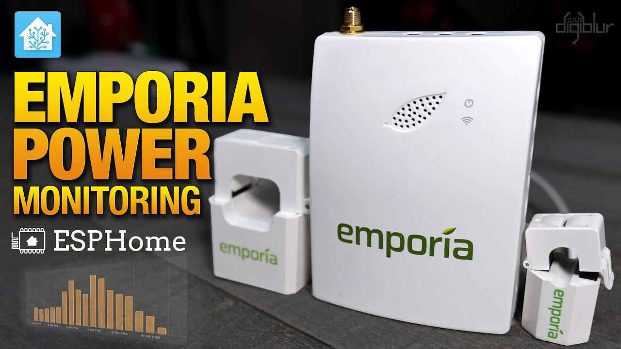

I bought an Emporia Vue 2 of Amazon about a year ago, comes with 16x 50A CT Clamps and 2 x 200A Ct Clamps (US SPlit Phase). Fits in with your DB Board and measure the power going over each one of the breaker switches (also available in an 8CT Clamp if you donât need that many)
Works very well but all the data resides in the cloud, there is an Non-Official Integration for home assistant and there were the normal issues with the cloud.
Great thing is that it runs and ESP8255 MCU and someone worked out how to reflash it with ESPHome.
There is also a pretty good video on how to install it
All data now goes directly to the MQTT broker in Home Assistant and doesnât use the cloud for anything. Is great value for money and beats out pretty much all the open source alternatives in bang for your buck. I have been running it for 2 months now and works very well.
