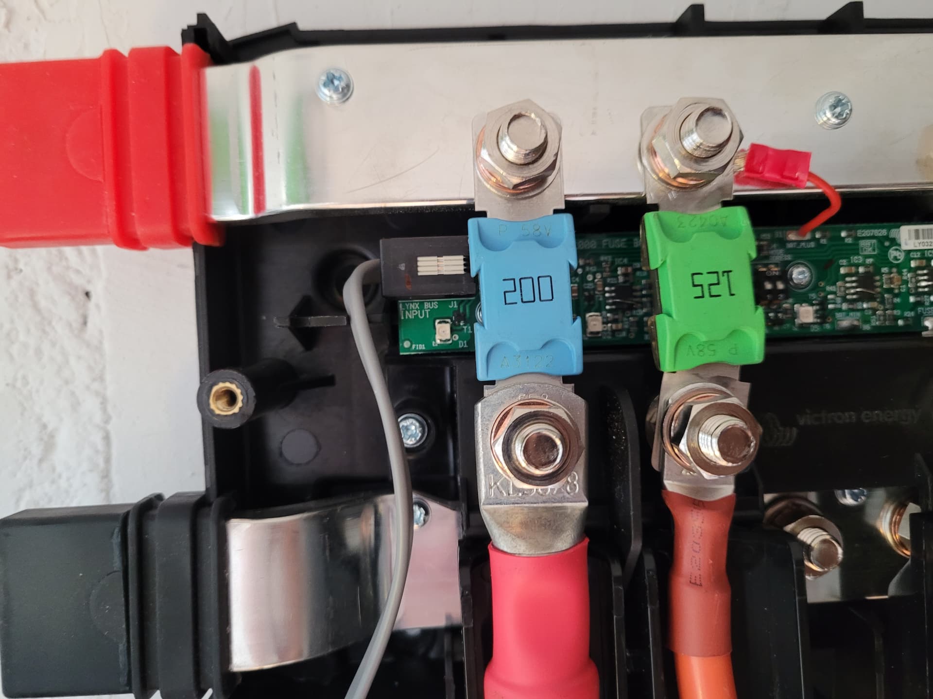

Edit: My situation, 18 cells, so 62.1v system, makes fuses a challenge. :rofl:
As I cannot use commonly available 58v (48v) fuses.
Just thought I put that here, in case someone else ever does the same.
I like the 521A fuse… Where did you find it? :upside_down_face:
If I did that, I would have turned that fuse around … OCD/DVD/PCP/VolKak whatever you want to call that. :+1:
