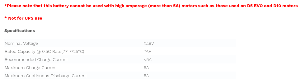

These look promising https://www.livestainable.co.za/product/linergy-12-8v-drop-in-replacement-lifepo4-lithium-battery-8ah-102-4wh/
Looks like that might just get you around 400W out of the inverter before the battery BMS kicks in.

2-3 weeks ago I put one of the black & green SecuriProd 7Ah ones in a UPS for a PC that doesn’t handle the Victron’s cutover time well, literally less than 1s at a time. PC’s one of those small Dell desktops, so not a beast by any means.
He’s dead Jim.
Not particularly surprising:
For that use case, lead-acid is by far the best option.
