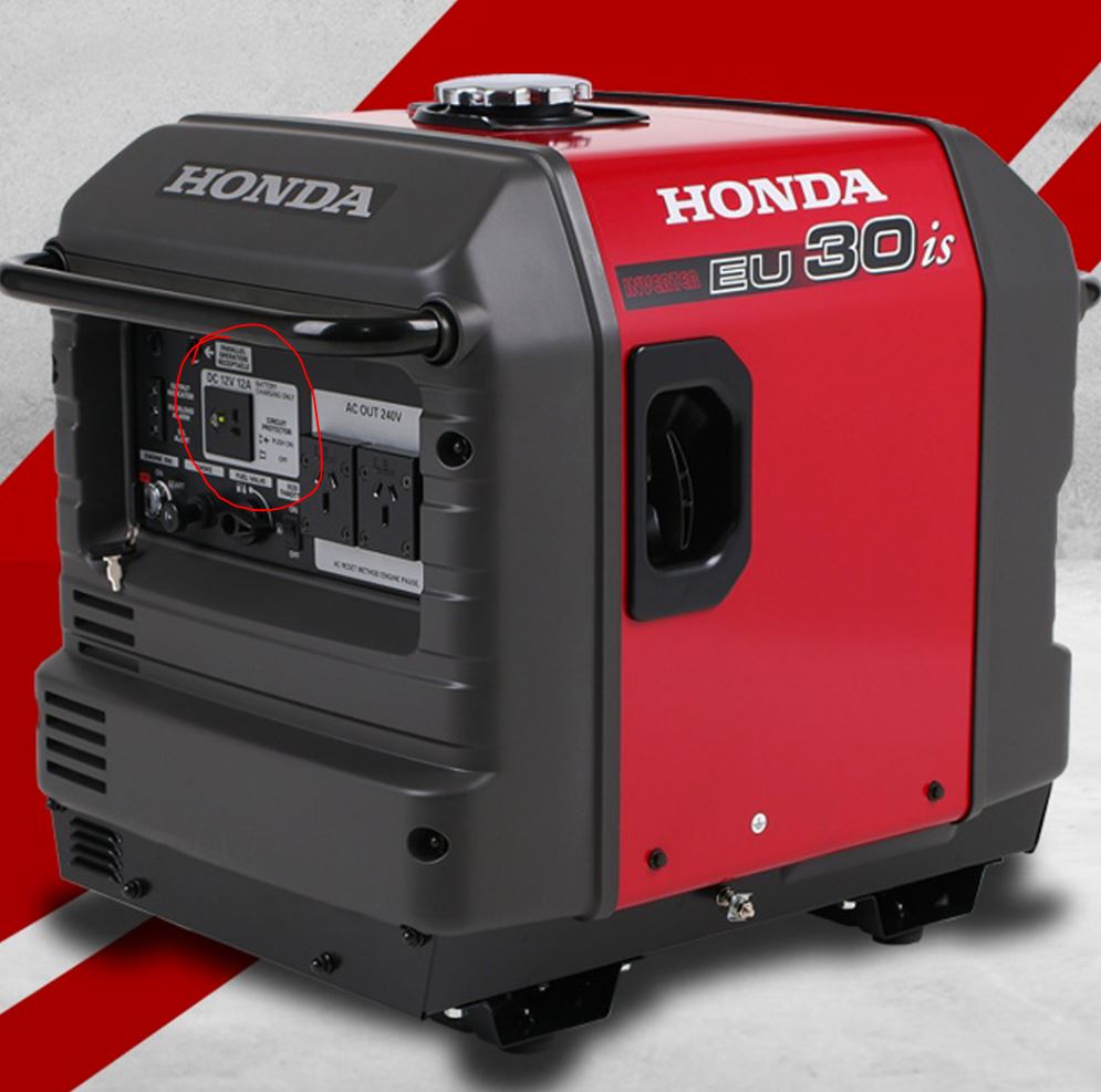

Phil, would the DC output on this inverter generator then count as a DC generator?
No, it must be at least 5V higher than the battery voltage for an MPPT input voltage and sufficient power.
That 12V output is neither.
