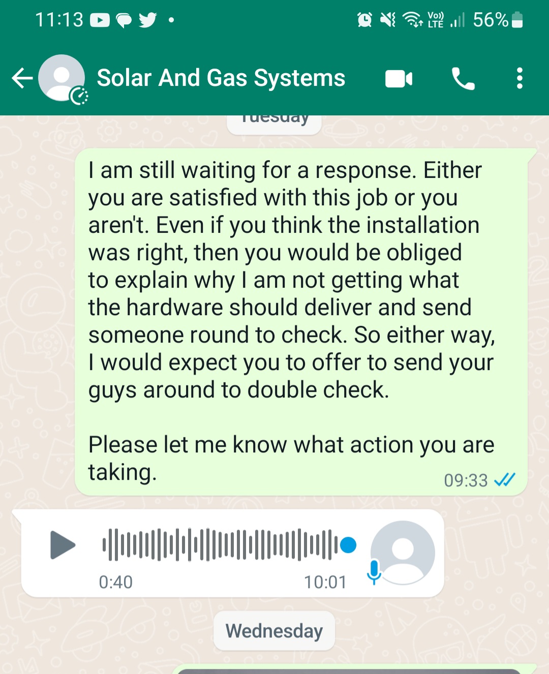

The supplier installer has bloked me on watsap and wont take my calls. I have come to terms with the fact that he will not honour any claim.
The best I can do is prevent others from falling for the same. He had dissapearing messages on watsap, and often replied with voice message. I even gave him a bad review on his facebook page. He simply blocked me there too.
Attached is my last message to him two days after thebinstallation his voice response tried to claim that it may be my inverter. And imediately blocked me.
