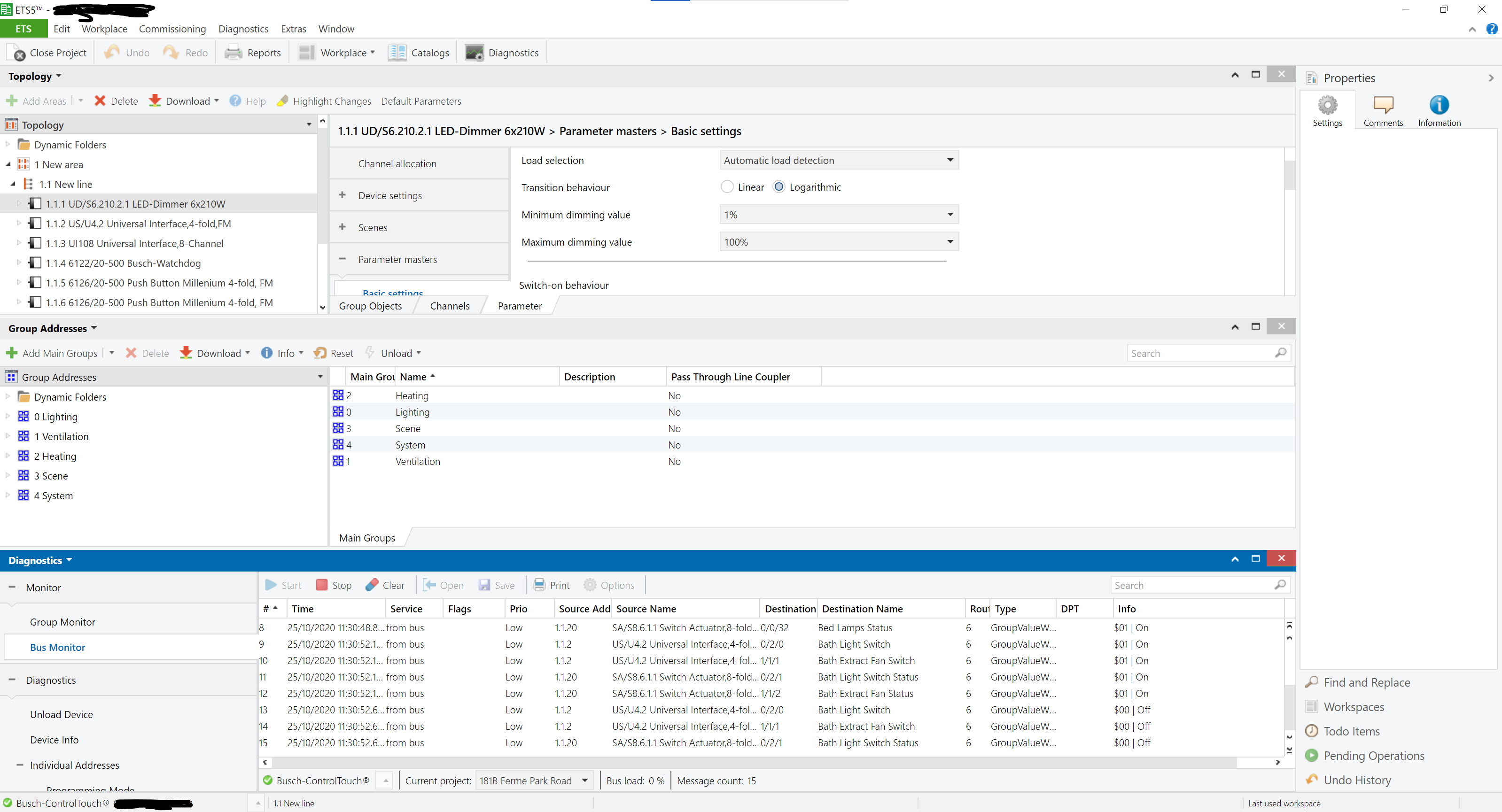

KNX is complicated, uses proprietary software that is very expensive and needed to configure the system and the devices themselves are VERY expensive - but uber reliable once setup.

Yep thats right - N2K is canbus. KNX is its own protocol running on a 2 core cable.
The advantage of KNX is that the 2 core cable carries both power and data over the twisted pair.
KNX uses 24v over its twisted pair, so that’s a plus
