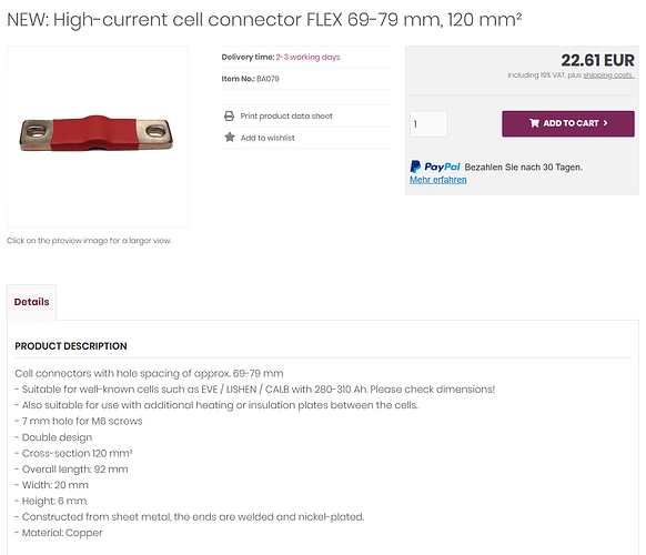

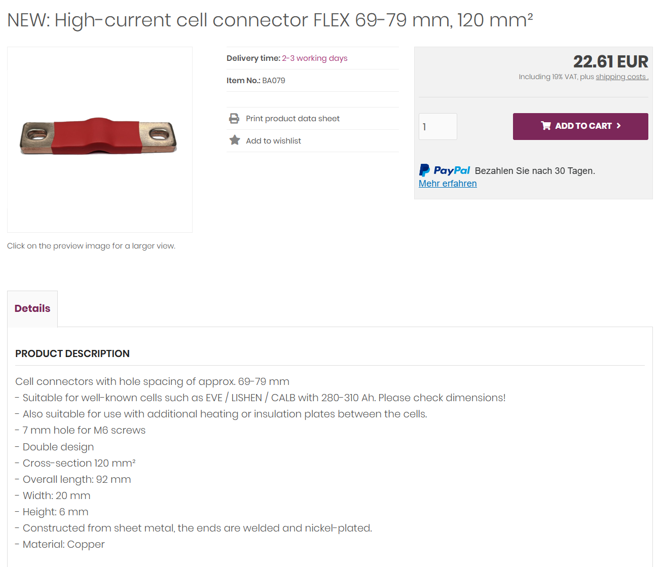

Nice Cell interconnects
These are very nice cell connectors - but holy moly - the price!
Is there anything like this available in SA ?
What about China - any solid reliable source for something like this? I doubt these are made in the NL - got to be coming out of China somewhere.
I want.
The text is in German? :slight_smile: I mean, close enough probably (just across the border)…
I doubt they are made in the EU at all. But damm they are nice - gotta be low resistance on these. But how many do I need for a 16s setup….hmm makes them pricey.
Think of it like this, pay $60 USD for an LF304 (ex China) and pay 45 EUR for two cell interconnects. Doesn’t make sense. The other way to look at it is, look how cheap LFP cells have become.

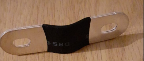

I have some like these somewhere.
Think they are for 100ah cells.
I think its just some shrink sleeving..

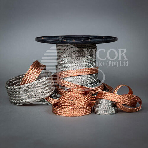

I believe these are made with lots of thin copper strips layered and this gives some flexibility.
