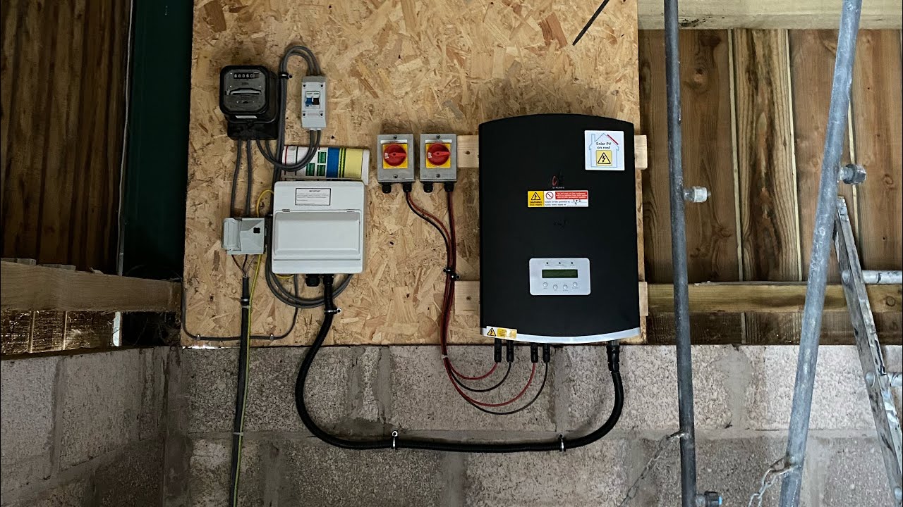

Grid tie inverter used in off grid application
This is a neat way of doing a distributed solar PV system.

What Richard is talking about, is connecting a PV-inverter to the output of the inverter (no grid supply), and then if there is more PV than the loads need, the inverter senses that energy is pushing backwards into the output, and it flips the buck/boost stage around and instead charges the battery.

The loads are serviced first and then the battery. Once the battery is fully charged the inverter frequency increases which throttles the PV inverter supply. (AC regulation)
Frequency shifting. Usually based on battery voltage. As the battery voltage gets closer to the required charge voltage, the inverter starts increasing the frequency, and it reduces power. Eventually it evens out and the PV inverter makes just enough to service the loads.

It needs to be able to do two things. It needs to frequency shift to control the PV-inverter, but it also needs to be designed and programmed to run things in reverse so it can charge the battery. Or in more technical language, that bit in the middle has to be a buck/boost design, so it can do both (buck means to convert downwards, boost means to convert upwards, of course).

I also found that the local support was wanting. There are 2 types of limiting that the inverter responds to: Frequency and the CT input.
The one that’s active locks the other one out. They are both active all the time so this can be a PITA…
Frequency shift has priority over the CT. In most cases, when the CT is in use it means you are connected to the grid, and you cannot shift the grid. When the grid disconnects and you are islanded, then the CT has no reading, and frequency shifting takes over. So the way you normally set it up, only one of them is used at a time.
But if the grid was to drift up to above 51.8Hz… then yes, that will take priority over the CT, and it will start limiting.
