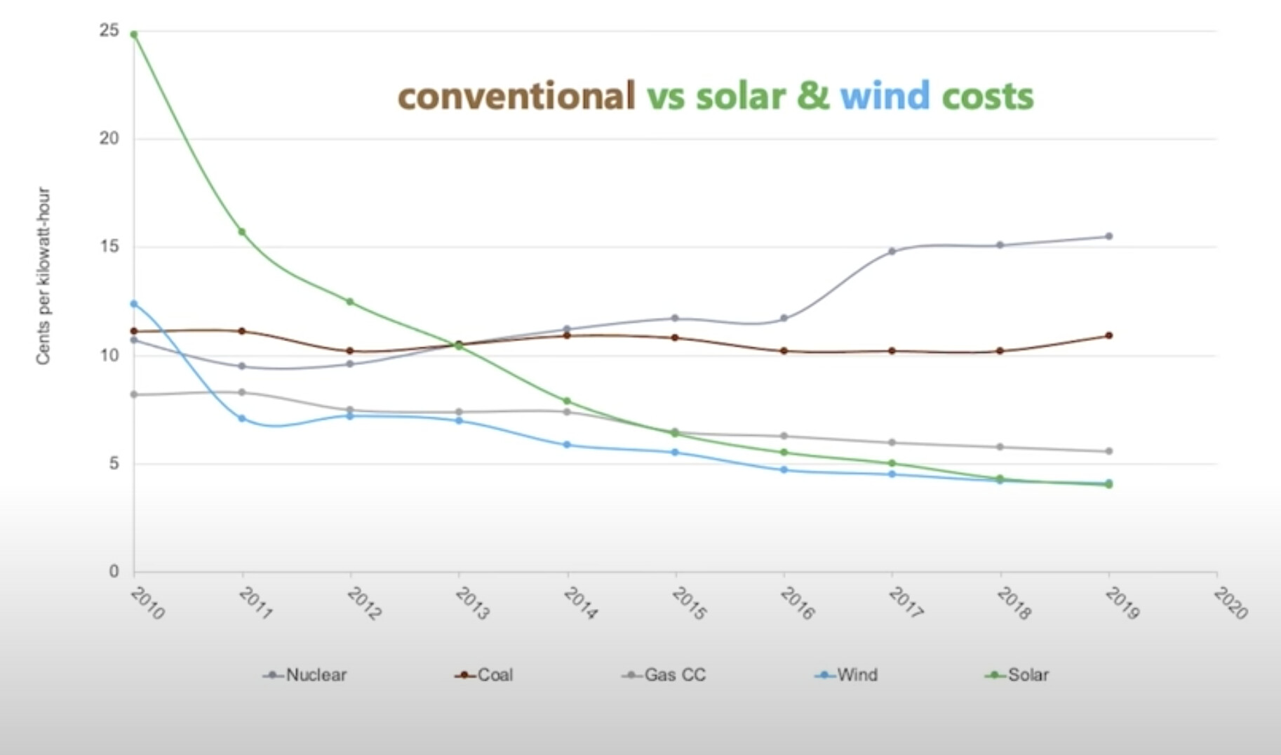

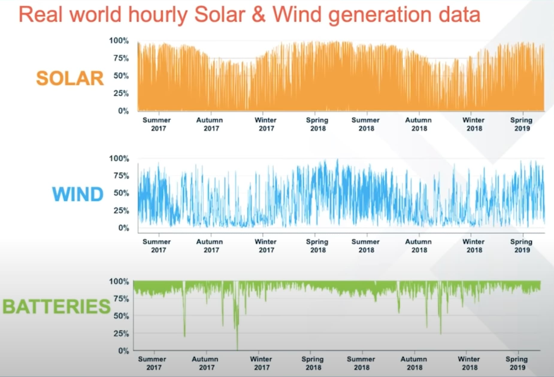

But anyhow, SWB (Solar Battery Wind) systems at 4X generating capacity is the sweet spot to deliver 100% of energy 24/7 locally.
Now, the kicker, to get to 100% availability for SWB, we need 4X Solar and Wind generation, and between 35-90 Hours worth of battery storage (weather and season dependent) for the complete SW generation capacity. This is non-linear to Coal plant, ie 4X more generating capacity.
Since 2019, SW is already cheaper than Coal or anything else. Battery storage is predicted to get another 40-50% cheaper by 2030. Tesla has reduced their Megapack storage by 20% earlier last month.
As a side note, SWB plants are already cheaper to build, and way way quicker with much less maintenance, than Coal plant Operating costs alone…

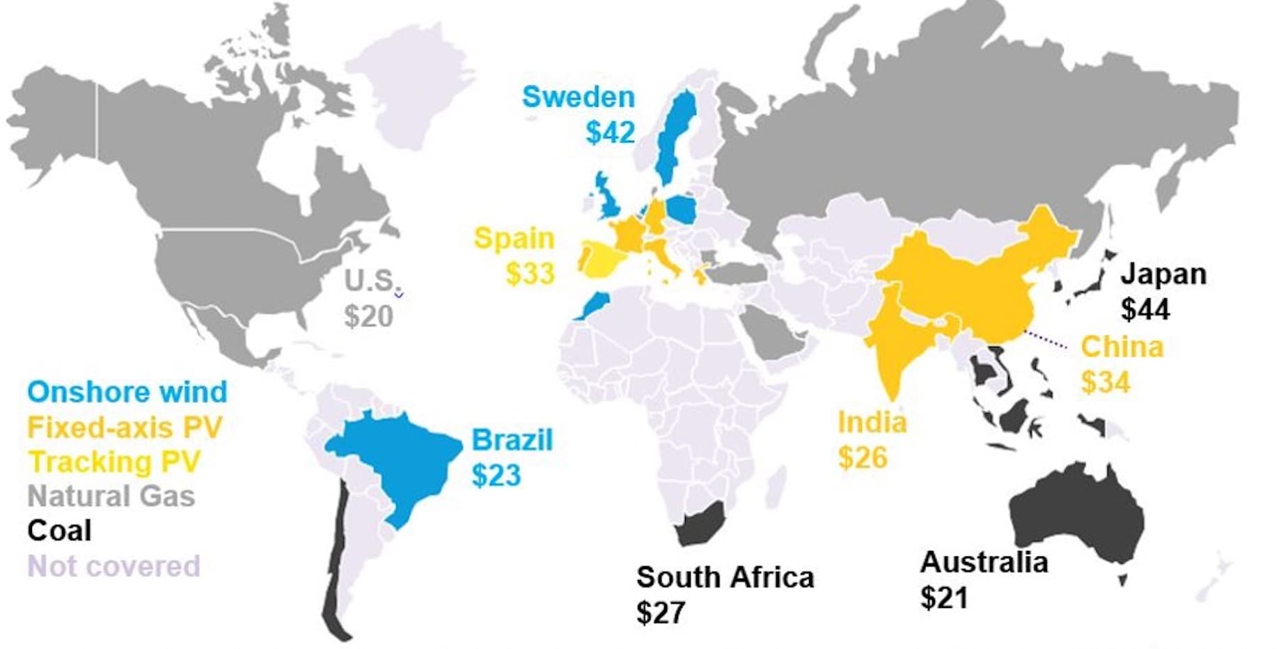

Source: BloombergNEF. Note: The map indicates for each country the technology with the lowest LCOE per MWh for new-build solar (yellow) and wind (blue) or running costs fo existing coal (black) or gas (gray). Running costs include a carbon price where applicable. Calculations exclude subsidies and tax-credits. Natural gas reflects combined-cycle gas turbines.
https://www.renewableenergyworld.com/solar/report-its-now-cheaper-to-build-new-solar-than-to-run-existing-coal-plants-in-china-india-and-most-of-europe/#gref

In China, the largest market for renewables, BNEF estimates the cost of building and operating a solar farm is now $34/MWh, cheaper than the cost of operating a typical coal-fired power plant at $35/MWh. Similarly in India, new solar can achieve a levelized cost of $25/MWh, compared to an average cost of running existing coal-fired power plants at $26/MWh.
Combined, China and India account for 62% of all coal-fired power capacity worldwide. Together the two countries produce around 5.5 gigatons of CO2 annually, or 44% of global power sector emissions.
From the article link above…

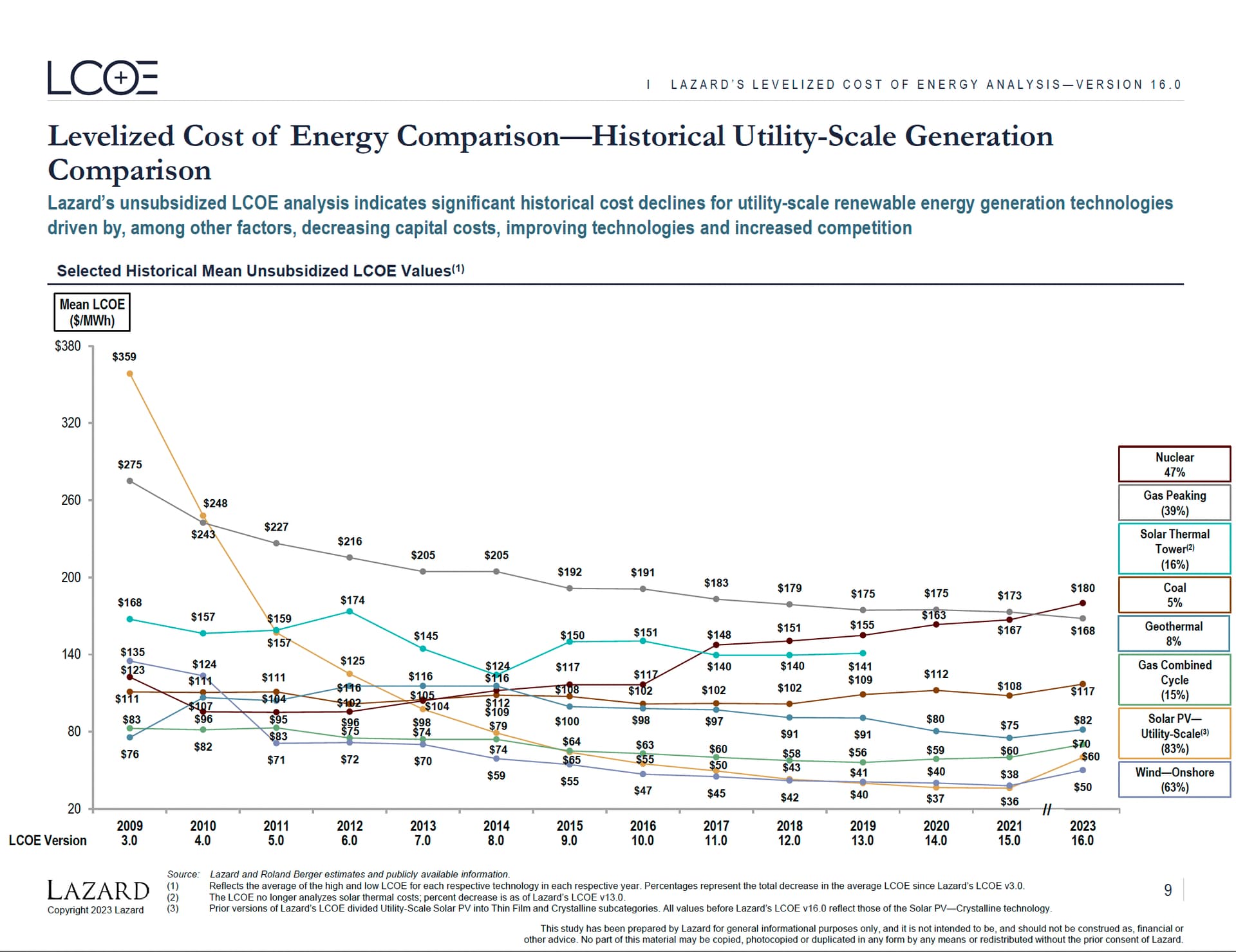

I’ll play devils advocate here, that LCOE probably doesn’t include the cost of BESS to “firm” up that supply of capacity, the anti renewable folks love pointing that out, I am a little lazy / busy at the moment so I don’t want to jump into the rabbit hole, can someone find us the LCOE on PV + Storage (Let’s say the typical 4 hour storage value I have seen other PV + Storage plants sporting)
From that link below, they have PV + BESS;
The daddy of LCOE:
https://www.lazard.com/media/2ozoovyg/lazards-lcoeplus-april-2023.pdf

And another view, over time to 2023. Look at coal ($117) vs PV+BESS ($60)
